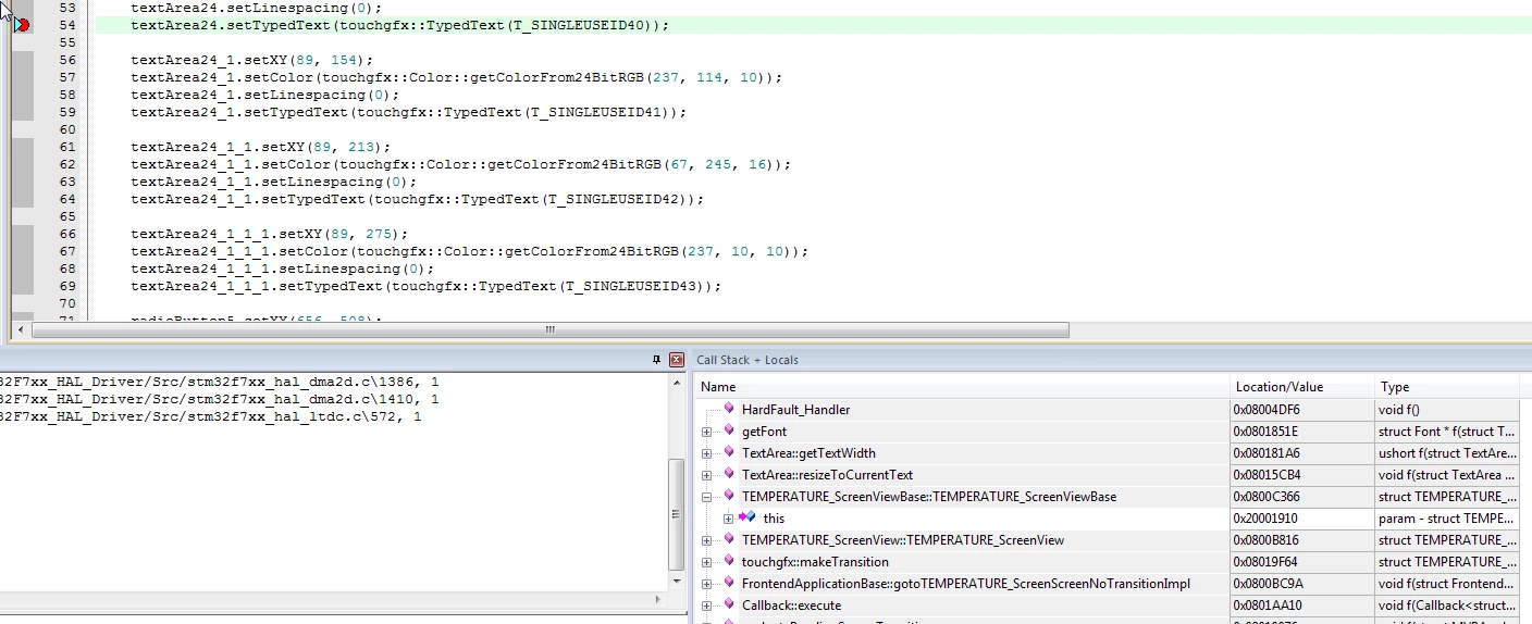

Look at breakpoint - this function halts (program go to HardFault)
You can see callstack.
How to find course of problem?

Hello, is the stack size proper for the application? (check and Static Call Graph)
December 5, 2020
Stack 0x2000 HEAP 0x4000
"(check and Static Call Graph)" - I can't understand this, explain please.
MM..1
December 5, 2020
Check your definition line for gui task, here need be when you use defaulot task
osThreadDef(defaultTask, StartDefaultTask, osPriorityNormal, 0, 4096);
