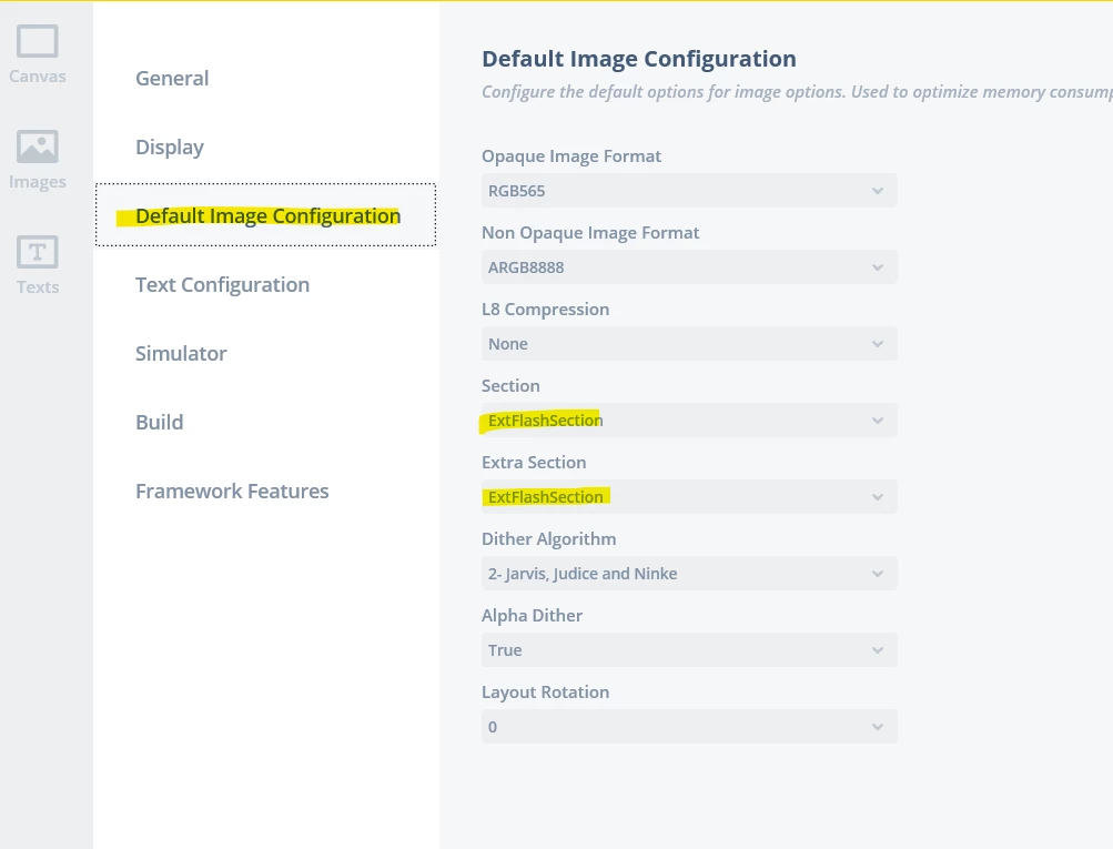

Hello @ikendal ,
If you want to put PNGs in external flash, you can do specify it from TouchGFX designer here :
How much your SVGDatabase takes in memory? (You can check that from the map file)
Do you have a lot of SVGs in your project?

Hello @ikendal ,
