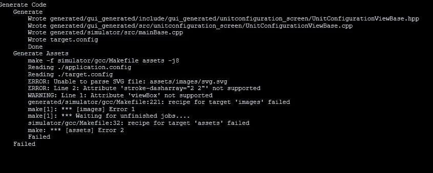

I'm trying to use SVG image in TouchGFX, but I got this error:
Maybe someone knows how to solve this error?

SVG is supported only in special format version.

Have a look at this link
https://support.touchgfx.com/docs/development/ui-development/touchgfx-engine-features/svg
TouchGFX does not support SVG images having any of the fields mentioned in the section
Unsupported SVG elements.
To check whether your SVG image has those elements, right click on the SVG image and open in notepad.
