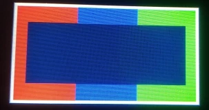

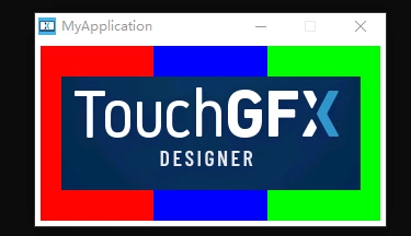

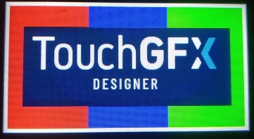

Below is the problem I encountered:
(Here are 2 images to displayed, RGB background image and Logo image.)
1) Touchgfx simulator:
2) Keil Project Effect:
3) Iar Project Effect:
