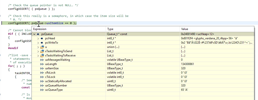

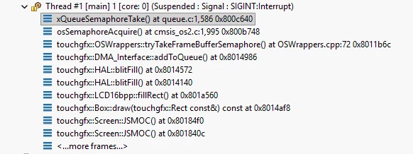

I am struggling to get TouchGFX running on my custom board. The processor is the STM32H7A3RGT and I am driving a 320 pixel x 960 pixel LCD display. I have allocated a frame buffer in internal RAM and have LTDC producing PCLK, DE, VSYNC and HSYNC. I have configured my firmware using CubeMX to use FreeRTOS. I added a call to MX_TouchGFX_Process in my default task but it gets stuck on an assert. Specifically here:
Call Stack
The reason it gets stuck is because pxQueue->ixItemSize is not zero !
ASSERT in xQueueSemaphoreTake
What am I missing ?

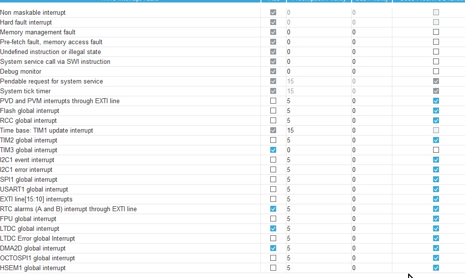

Check in MX NVIC interrupt settings for all hw … Next in MX TouchGFX check your setup is LTDC for type and for timing.
Aug 22, 2026 1:40 PM UTC
Thanks for the reply - what specifically am I looking for in NVIC?
I have configured everything for LTDC and am seeing what looks like good signals on PCLK (10MHz), DE, VSYNC and HSYNC.
This looks more like a firmware issue in that xQueueSemaphoreTake is expecting an item size of 0 and the item size is 320.
Looking at the stack trace, it looks like TouchGFX is trying to ‘blit’ to the frame buffer and I am suspicious about the 320 as that is the width of my display in pixels.

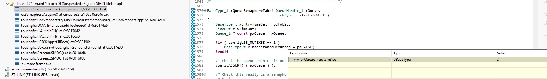

Sep 25, 2026 9:45 PM UTC
Actually, seems my issue has not resolved itself :-(
I made a few changes to my board and created a new CubeMX project, transferred all the settings relating to LTDC, TouchGfx and FreeRTOS and I am back to seeing the same problem where it get stuck:
Again, you can see that it asserts because uxItemSize is not zero.
I don’t know how I managed to fix it on the previous board.
Andy
MM..1
Sep 26, 2026 10:48 AM UTC
Maybe old MX bug. After new project first generate was not complete… Repaet open ioc and try second generate.
Or your GUI task require bigger stack setings
