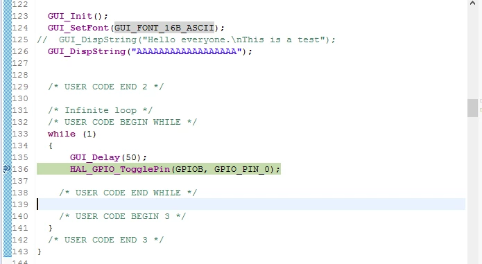

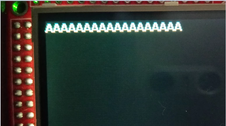

I'm working on STemWin532 library on STM32F103ZET6 bord in STM32CudeIDE. I could successfully configured LCD interface (The Controller is HX8325B and GUI runs on internal RAM) and insert some text on the screen (following image):

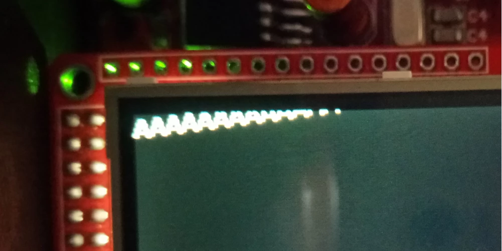

But when i use external SRAM as GUI memory result is very strange and interesting :). The text is driven out of the screen. The following picture shows the situation:
While the code is the same code that works correctly in the internal RAM of MCU. The only command that i changed is the following variable definition for GUI memory allocation:
#include "GUI.h"
#define GUI_NUMBYTES 1024*50
U32 static aMemory[GUI_NUMBYTES/4]; // This is for internal RAM
U32 static aMemory[GUI_NUMBYTES/4]__attribute__((section(".GUI_0x68000000"))); // This is for extenal SRAM
void GUI_X_Config(void) {
 GUI_ALLOC_AssignMemory(aMemory, GUI_NUMBYTES);
The section .GUI_0x68000000 is defined within linker command file as follows:

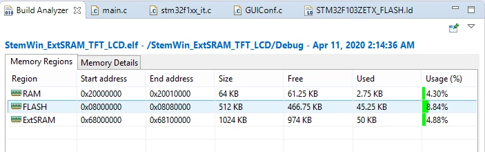

Build Analyzer output of CudeIDE shows the memory usage:
There is no hard fault in execution procedure and while(1) loop is executing as normal:
