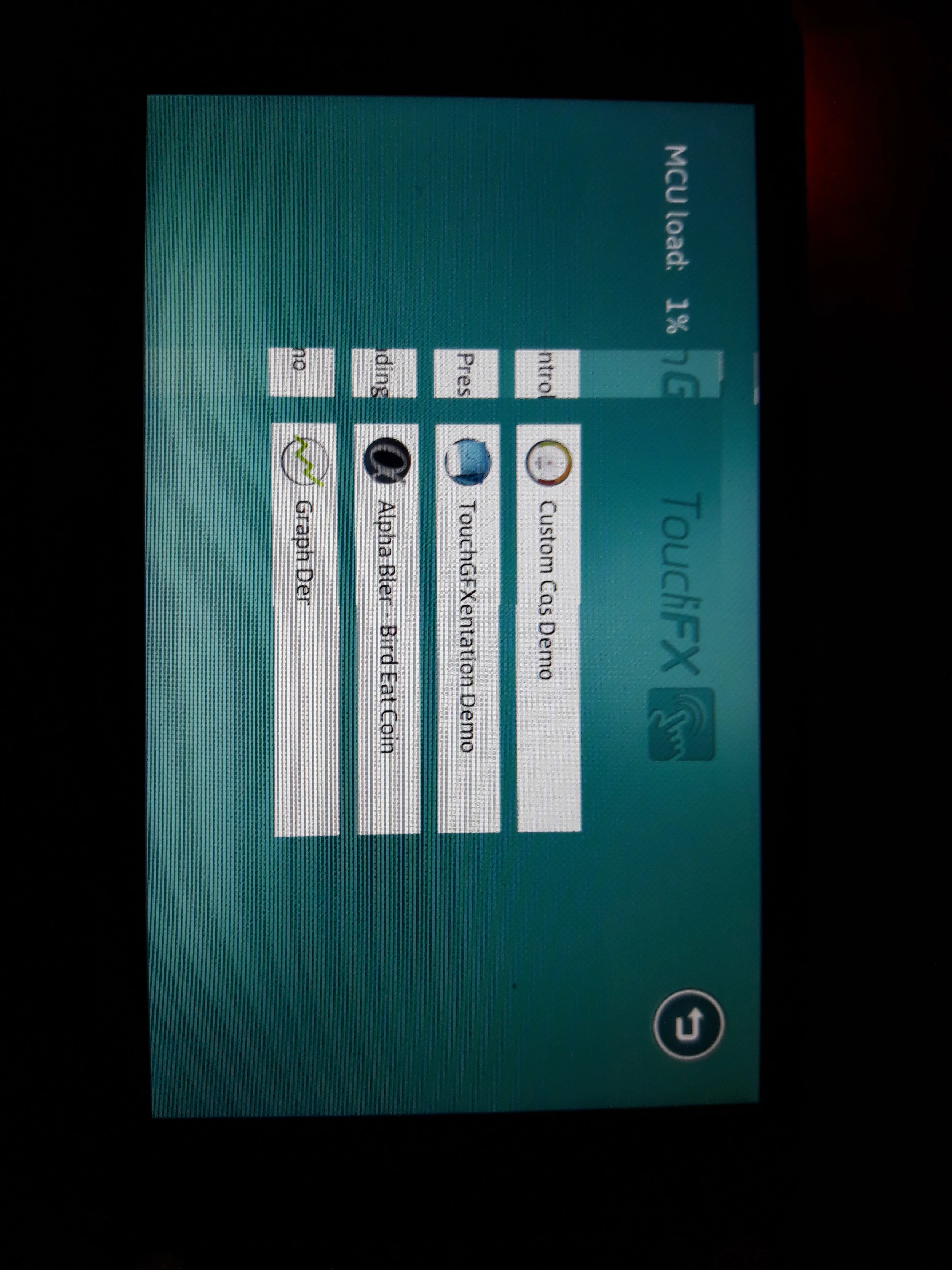

olivier.scalbert
November 1, 2020
Ok, I have installed CubeProgrammer, select the External loader.
Things are better but not fully ok. Here are the logs and a photo of the main menu.
Note: it is compiled in debug mode.
olivier.scalbert
November 1, 2020
olivier.scalbert
November 1, 2020
For your info, I have done the same thing with the TouchGFX demo for the STM32F769I Disco and it works well !
So my setup seems ok.
