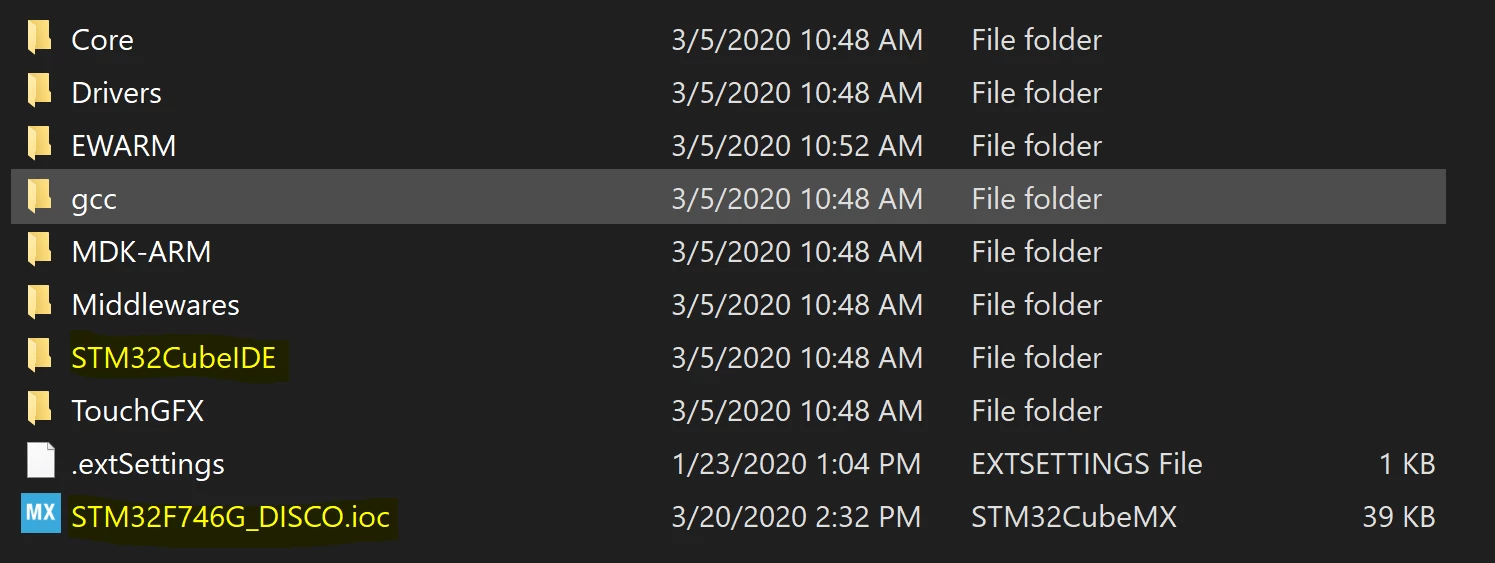

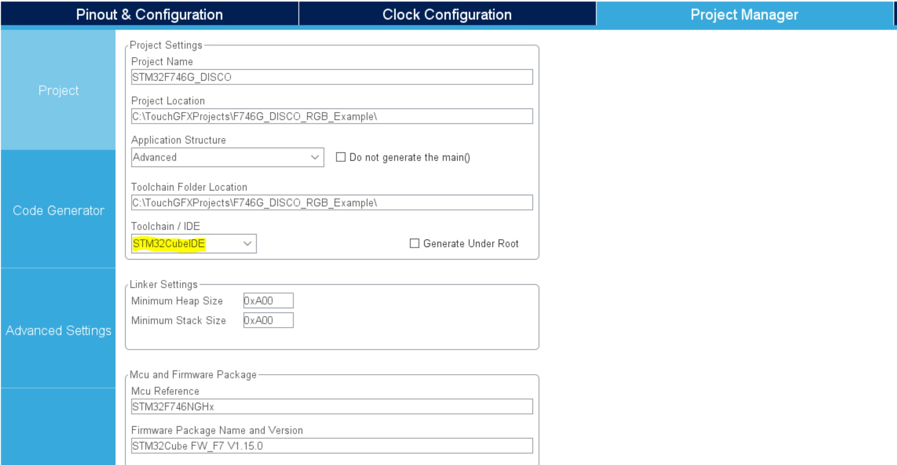

The Application Template STM32F746G-DISCO v3.0.0 is available in TouchGFX Designer. I do not know if you already used it but this version allows you to use CubeIDE. You then just have to add your GUI code to make it work. This is the recommended way for creating a project based on an ST board like EVAL or DISCO.
In this setup, you will find a .ioc file. This file can be open with CubeMX. This is where CubeIDE is already selected so you should not have to do anything with that.
Just go to STM32CubeIDE folder and click on the .project file. This will open your project and you can build and download into your board.
