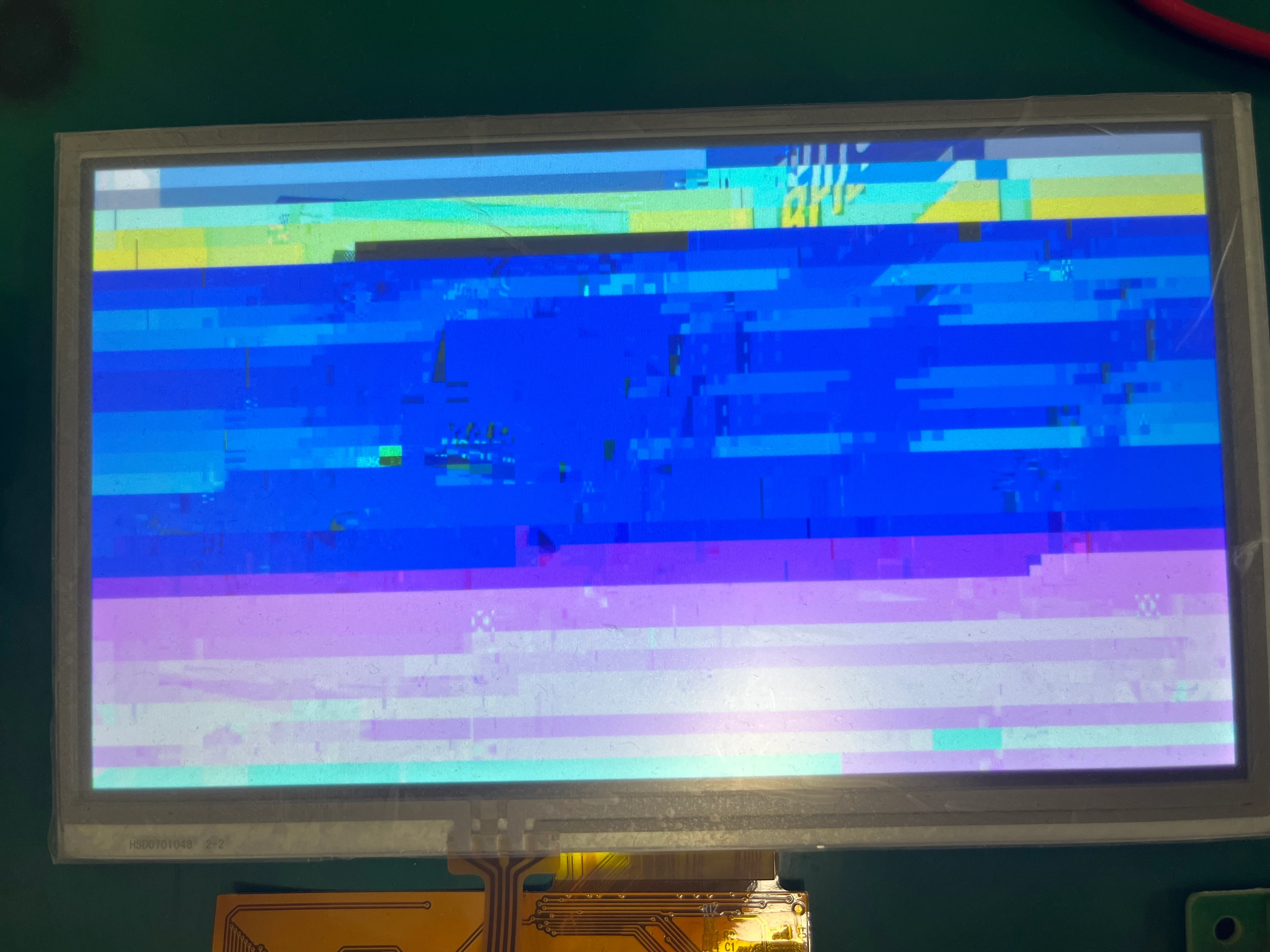

Issue Description
MJPEG intro video plays inconsistently. The first frame is partially decoded (top 16 pixel rows visible, rest of framebuffer shows stale main-screen content). The TouchGFX task then blocks indefinitely on SEM_WAIT(semDecodingDone) and the system enters the FreeRTOS idle task (prvCheckTasksWaitingTermination).
Same code, same setup, three different runs produce three different outcomes:
Run 1 (best case)
dbg_jpeg_irq          = 3
dbg_gpdma_ch0_irq = 1
dbg_gpdma_ch1_irq = 34 (≈ 1.13 frames worth, 30 per frame expected)
hjpeg.State = HAL_JPEG_STATE_READY
hjpeg.ErrorCode = 0
LCD = First frame partially decoded, then stops
Run 2 (long-running then fails)
dbg_jpeg_irq          = 260
dbg_gpdma_ch0_irq = 0 ← Input DMA never raised TC IRQ
dbg_gpdma_ch1_irq = 7680 (= 256 frames decoded)
hjpeg.State = HAL_JPEG_STATE_RESET
hjpeg.ErrorCode = 4 (HAL_JPEG_ERROR_DMA)
LCD = Many frames played, then frozen with broken content
Run 3 (fails immediately)
dbg_jpeg_irq          = 0
dbg_gpdma_ch0_irq = 513 ← IRQ flood, only 1 byte consumed
dbg_gpdma_ch1_irq = 1
hjpeg.JpegInCount = 1
LCD = Main screen, video never started
Run 4 (256 frames + IRQ runaway)
dbg_jpeg_irq          = 516
dbg_gpdma_ch0_irq = 16,777,216 (= 2^24, runaway IRQ after error)
hjpeg.ErrorCode = 4

1 reply
Aug 12, 2026 9:51 AM UTC
Can you fit the video in internal flash? If so, does that work?
Do normal bitmaps read from external flash look normal?
