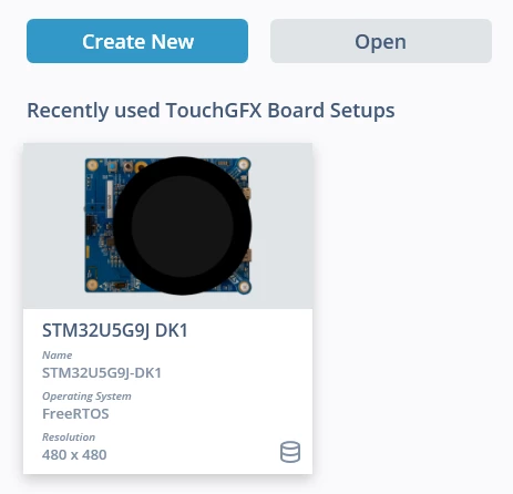

I am using TouchGFX Designer to generate my firmware for STM32U5G9J-DK1 board.
I have attached my firmware which is working good with 2 lanes in same board.

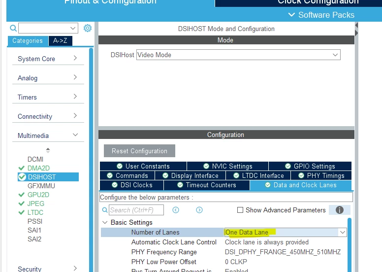

As highlighted in below screen shot, I am changing data lines to one but it is not working.

When changing to one lane, the value is correctly changed from DSI_TWO_LANE to DSI_ONE_LANE in main.c at line 434 :
hdsi.Init.NumberOfLanes = DSI_ONE_DATA_LANE;
However, I have not been able to compile your program in either cases.
I don't know how your project have the DSI enabled but not mine.
To create your project you:
  1. open TouchGFX Designer
  2. click on Create new
  3. Select STM32U5G9J-DK
When I do that I end up with a project that I can compile and that disable DSI.
If you followed the 3 steps above, did you select the project with FreeRTOS or with ThreadX?
Which version of TouchGFX and STM32CubeMX are you using? The latests?

Immediate problem that I noticed is, you are selecting wrong board. Please select STM32U5G9J-DK1 instead of STM32U5G9J-DK.
I used below board.

1. As STM32U5G9J-DK1 board display module has 2 data lane, can I use only single data lane of it? If yes, what should I change in firmware (and/or hardware) to make it possible?
Even though the STM32U5G9 can work with single lane DSI, you cannot use single lane data on the STM32U5G9-DK1.
This is because even though you can change the DSI host to single lane, you cannot change the LCD's DSI parameters.
However, the STM32U5G9 is perfectly capable of controlling a screen using single lane DSI so this should be no problem for the custom board you want to create.
2. If above is not possible due to some limitation, I have to connect single data lane LCD module with STM32U5.Do you have any suggestion of LCD module that I can purchase? What change I need to make in my firmware to make that LCD module work.
We cannot really recommend you a display as there is many of them, just make sure it can run a single lane DSI and the other communication protocol, voltage, etc are compatible with the board you want to use.
Keep in mind that DSI are quite complex to work with.
Here is a good starting point tutorial (they use a screen that I don't think is still sold) : initializing-mipi-dsi-displays-in-command-mode/ . This guide helps you adapt the connection to fit STM32 board as well as managing the setup of the screen.
Once you get your display, you could start creating your project by taking inspiration from the STM32U5G9-DK1 TBS but you will have to change the display firmware to match with the vendor's datasheet (initialization, timings, etc).
