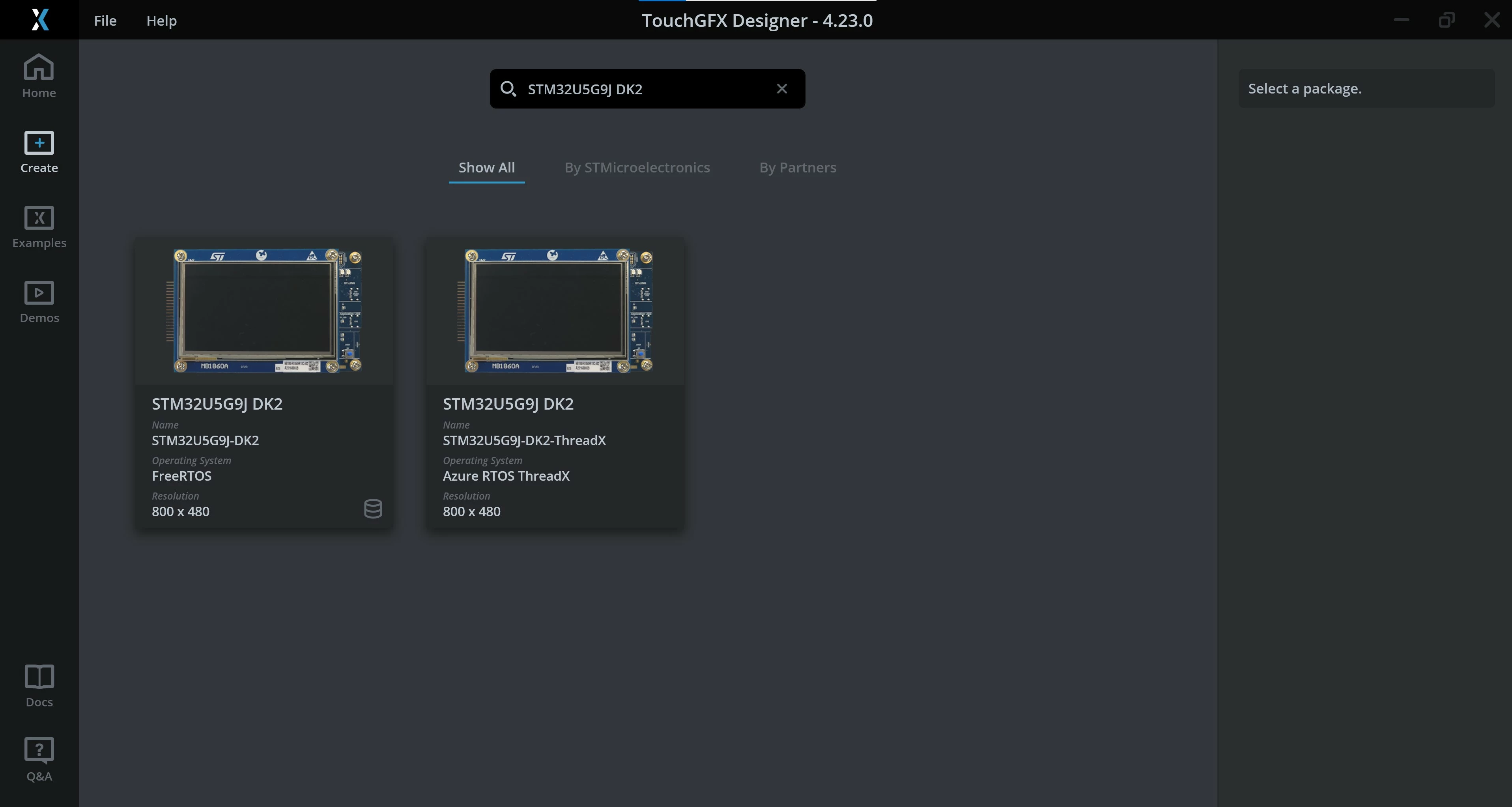

Yes, they do. Both will have NeoChrom graphic accelerator which helps a lot with vector renderings. And, this feature is enabled on the STM32U5G9J-DK2 available on TouchGFX.
STM32U5G9J DK2 Board SetupSTM32U5G9J DK2 Board Setup
You can read more about vector rendering here

1) No, You can use any other compiler for developing. IAR was the first toolchain to support it, but now you can use IAR, STM32CubeIDE, and MDK-ARM for development.
2) Yes, STM32U5G9J-DK2 has a 800*480px display.
