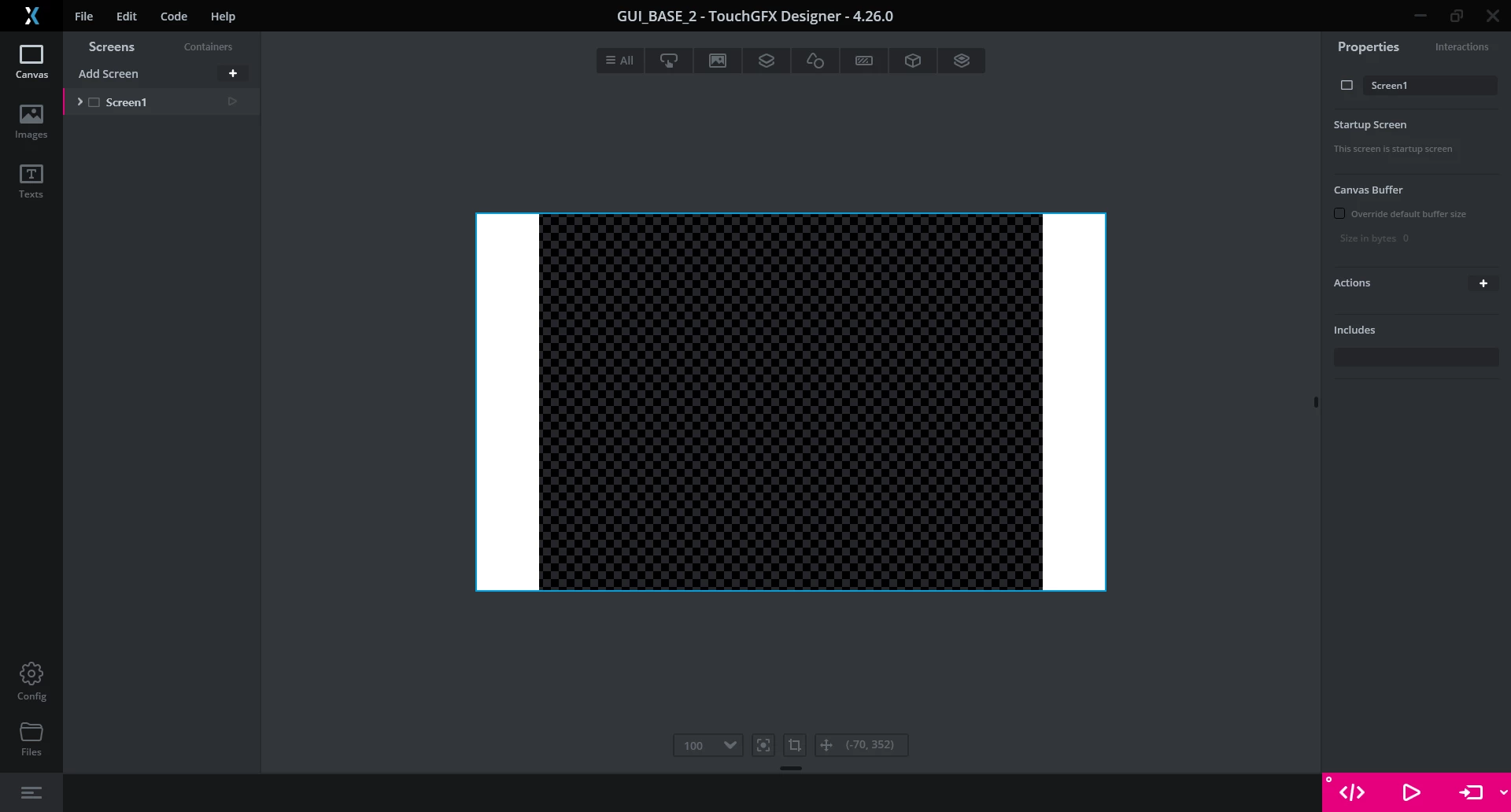

I am working with the STM32N6570-DK board and trying to display the live camera feed on a TouchGFX application.
I cannot find any ready-to-use example that integrates DCMIPP (Camera) and TouchGFX.
Current Situation:
  1. TouchGFX Designer: I have created a UI with a transparent area in the center (Alpha = 0) to display the camera feed. (Please see the attached screenshot).
  2. Cube IDE Firmware:  I found the DCMIPP_ContinuousMode example and confirmed that it works fine independently. However, merging it into a TouchGFX project manually is quite difficult for me.
My Question:
Is there a simple, official example or Application Note demonstrating Camera Preview (maybe on Layer 0) + TouchGFX UI (maybe on Layer 1) for the STM32N6570-DK?
Since I am new to the STM32N6 series, a detailed, step-by-step explanation would be very helpful.
I would appreciate a quick guide or a GitHub link.
Thanks.

An official example is now available in TouchGFX Designer (4.26.0) under Demos > Board Specific Demo:

From my understanding, the video frame must be resync by the TouchGFx engine.
You can refer to the following documentation :
MJPEG Video | TouchGFX Documentation
I would start the trial with simple jpeg picture from the camera (DCMIPP+VENC) then configure Touchgfx to linked the image output buffer to the input widget cf Decoding Strategies chapter.

Hello Simon,
I carefully read the documentation you linked.
However, I could not find any information related to "Camera" or "Live Input" in that document.
It only explains how to play video files stored in memory.
Since I am a beginner, I don't understand how to convert the Camera stream (DCMIPP) into a JPEG/AVI format in real-time to use this widget.
Is there a simpler way to just show the camera feed without encoding/decoding it as MJPEG (like DCMIPP_ContinuousMode Example)?

Hello @JinukLee ,
I understand that you’re frustrated and under pressure, and I’m sorry that our current examples and tools did not meet your expectations. However, I’d kindly ask you to keep the discussion respectful. We absolutely want to hear feedback, critical included. But personal attacks and assumptions about people’s work or motives don’t help anyone, including you.
STM32N6 is still a relatively new product (a bit more than a year since it was announced). And within this year, if you look closely in Designer, we have updated our TBS 5 times, and made also another example working with FreeRTOS, while still providing demo examples suitable for this product. That is to say, we have been very active updating our product, making it more mature, and also more user friendly with improving the debugging experience or making it compatible with a lot of different compilers.
That said, you’re right in the sense that its ecosystem is not yet as mature or straightforward as a long‑standing family like STM32F4. The complexity level is also not the same.
Regarding the specific N6+camera example you mentioned, we have made internally a project that runs on STM32N6 with the camera module shipped with the kit, which shows the camera stream in a TouchGFX application. Our intention is to make this available to everyone in TouchGFX Designer as a Board specific Demo (BSD). However, we encountered the same layer issue you mentioned and also another one with the dynamic bitmap bytes alignment.
Instead of publishing a version of this example with a temporary workaround that many users would find confusing or fragile, we are working on a proper official fix, and ensure it is maintainable and understandable, not just “barely works”. Rest assured that we will publish this as soon as possible.
