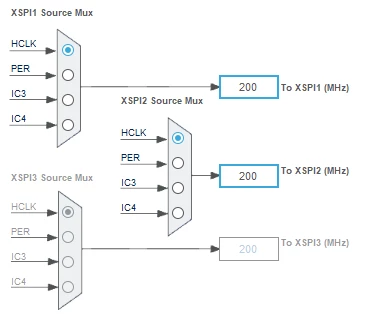

What is the clock source for your XSPIs?
We have changed this from PLL to HCLK at some point, because we found that the PLLs created problems when resetting the chip.
TerZerAuthor
Oct 8, 2026 12:02 PM UTC
The clock source is HCLK.
