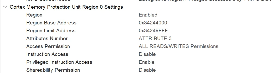

Have you made sure the memory that is used for the GPU command list is non-cacheable?
Are you able to share your project?
Riya_LAuthor
Jun 25, 2026 12:43 PM UTC

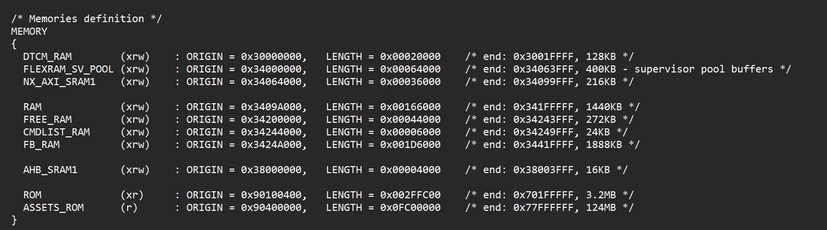

Unfortunately, I'm not able to share the project itself. However, I've attached my MPU configuration and linker script screenshots below. Could you please take a look and let me know if anything stands out or if any of the regions used by TouchGFX should be configured differently?
Memory definitions in Linker Script
MPU configs for CMDLIST
Jun 29, 2026 7:00 PM UTC
I don’t see a problem with that configuration.
It looks like you use VENCRAM and CACHEAXI as normal RAM. Have you handled that in code? In the TouchGFX project we do this:
