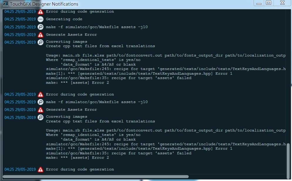

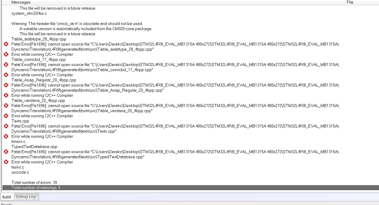

0690X000008a7XBQAY.jpg0690X000008a7XGQAY.jpgHi Martin,
We load this project in TouchGFX designer 4.10.0. It shows errors when doing code generation. We compile this project. It shows some files is missing. Could you help ? Thanks.
Martin KJELDSEN
Principal III
May 29, 2019
The first screenshot definitely says that you have no generated files (by designer) to compile. They cannot be found. The second confirms that code generation failed. I may need to see your project.
MHo.15
May 29, 2019
Hi Martin,
The code generation failure causes the file missing in compilation. Please check attached project file after code generation. Thanks.
