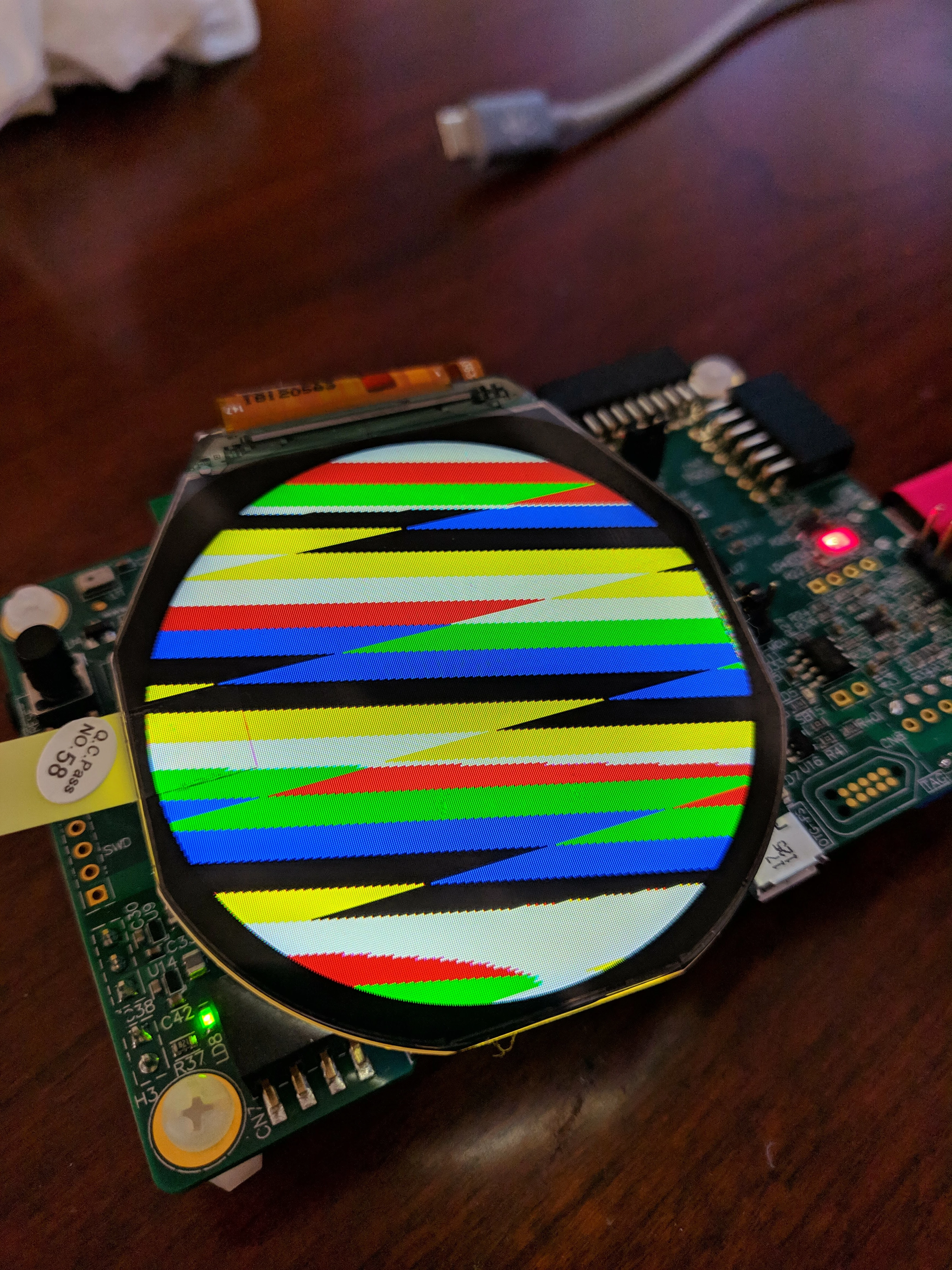

Working on getting a new TFT DSI LCD display to work on the STM32L4R9I-DISCOVERY kit. It uses the ST7796H2 display driver. emWin shows they have added support for this in their 5.36 version in the GUIDRV_FlexColor files, but STemWin is only reved to 5.32.
TouchGFX doesn't use the GUIDRV_FlexColor, where are the hardware specific files for editing to add support for this new LCD? I've read: (https://touchgfx.zendesk.com/hc/en-us/articles/204993942-Changing-to-a-different-display) but it doesn't mention specific file and I've browsed through various files without noticing the right one to work with. (GuiConfig.h, gui_main.h/cpp, stm32l4xx_hal_lcd.h, ...)

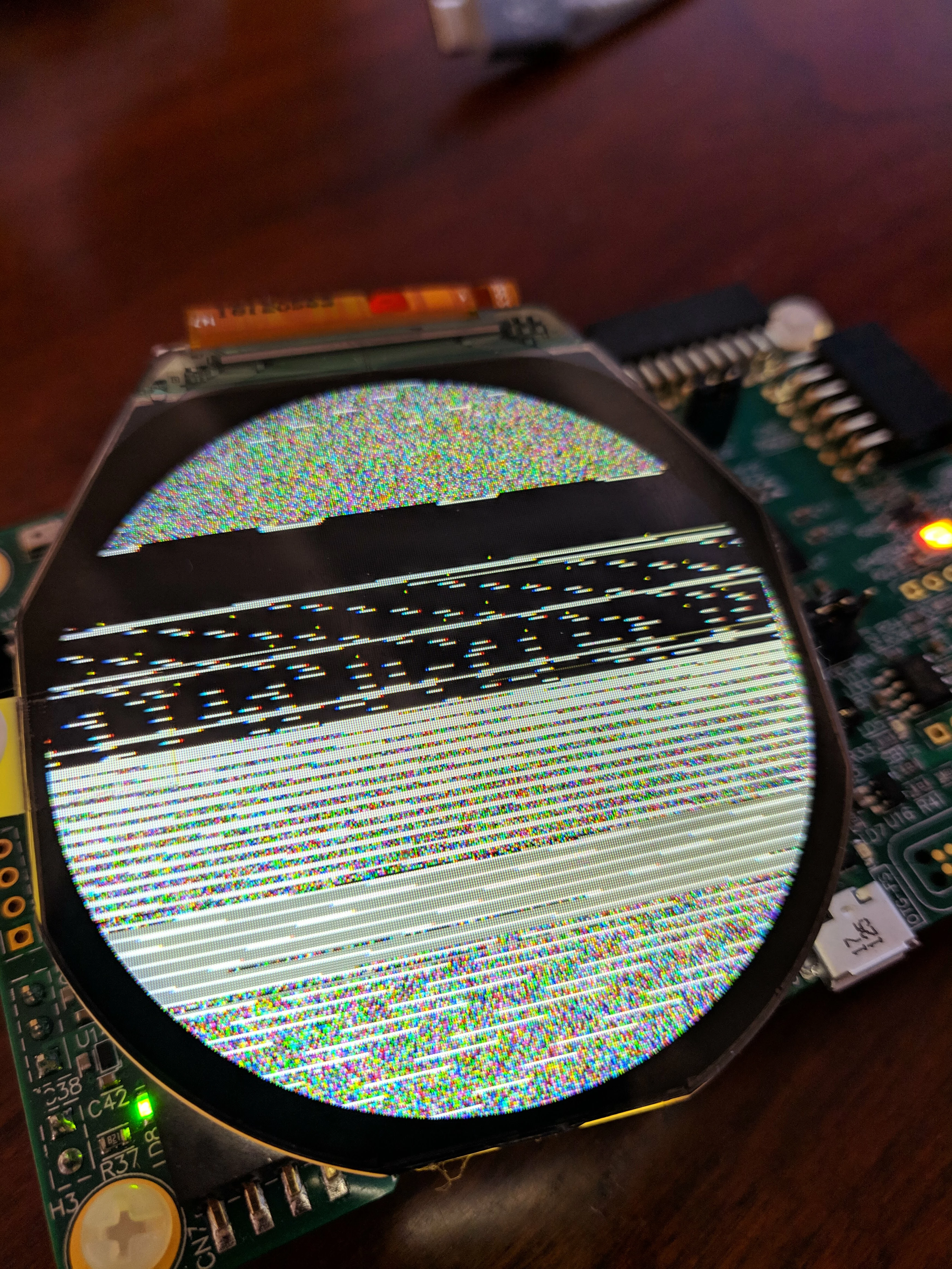

Du1Author
January 23, 2019
Got the display and edited the gui_main.cpp generated from TouchGFX and got the following image (image with black line). Then tried editing the code where it calls for the LCD size and edit it to 320 from 390. Then regenerated the LUT with the CubeMX using a square 320x320 instead of a round 320x320 and got the 2nd image (all pixelated). Seems to indicate I need to modify the LUT for a round 320x320 and any other code that deals with round lcd... the saga continues...

Mon2
Senior III
January 23, 2019
Yes, this will be a bit of a life sucking exercise. Be sure to compare your register values against other source code examples on the internet using the same display controller. Also the mfr of the display should be able to supply you with source code samples. We kind of cheated on our pending design and insisted on the use of the ILI9341V controller which is onboard this ST kit but had a custom flex cable produced for our company so we can mate with a zero force blade socket.
Check the clock value for this display as it almost looks like you are close in this posted screen shot. The clock value may be too high. Just an observation. Keep at it :grinning_face:

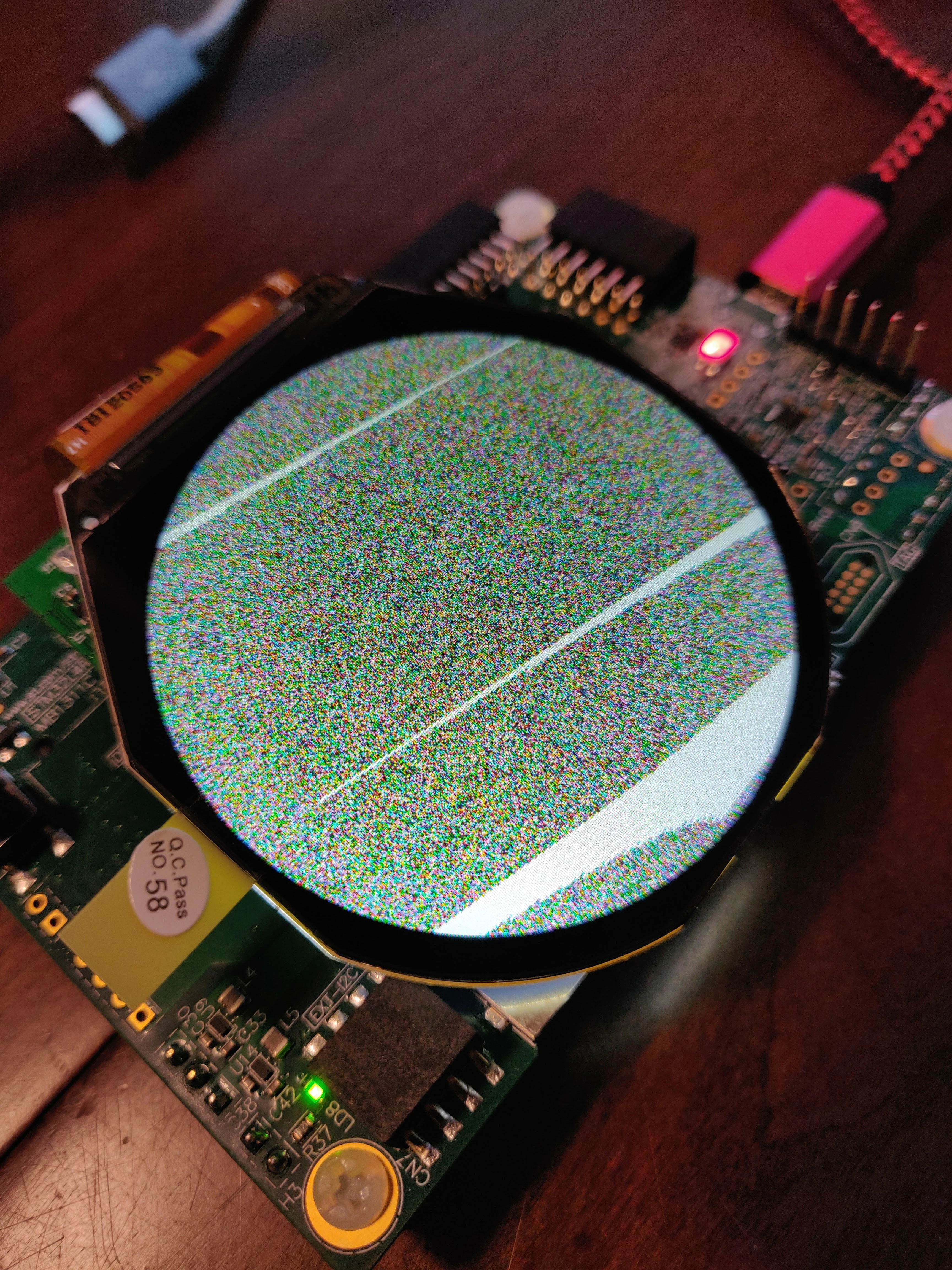

Du1
Du1Author
January 23, 2019
Bit more progress, the LCD is showing the pattern, but not in the right place, need to find correlation with displayed pattern and how to fix it in LUT...
Mon2
Senior III
January 23, 2019
Review the DSI document from Qualcomm that is attached. Specifically table 3-1 and see if it helps. Keeping in mind that DSI registers are supposed to be common across any vendor of the display, review the horizontal values to see if they impact your display. This is exciting as it appears that you are getting closer!

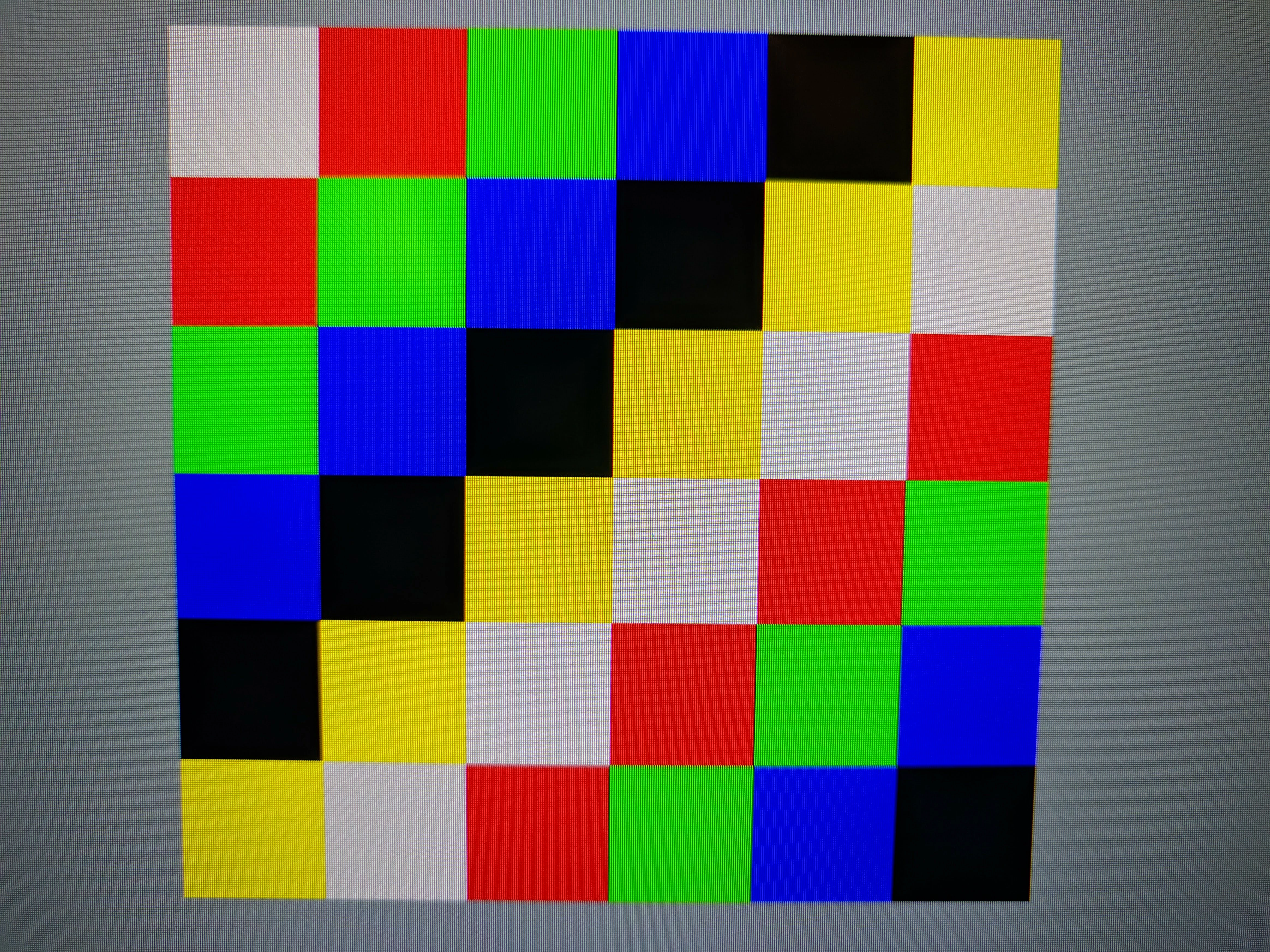

Du1Author
January 23, 2019
The pattern should be this.

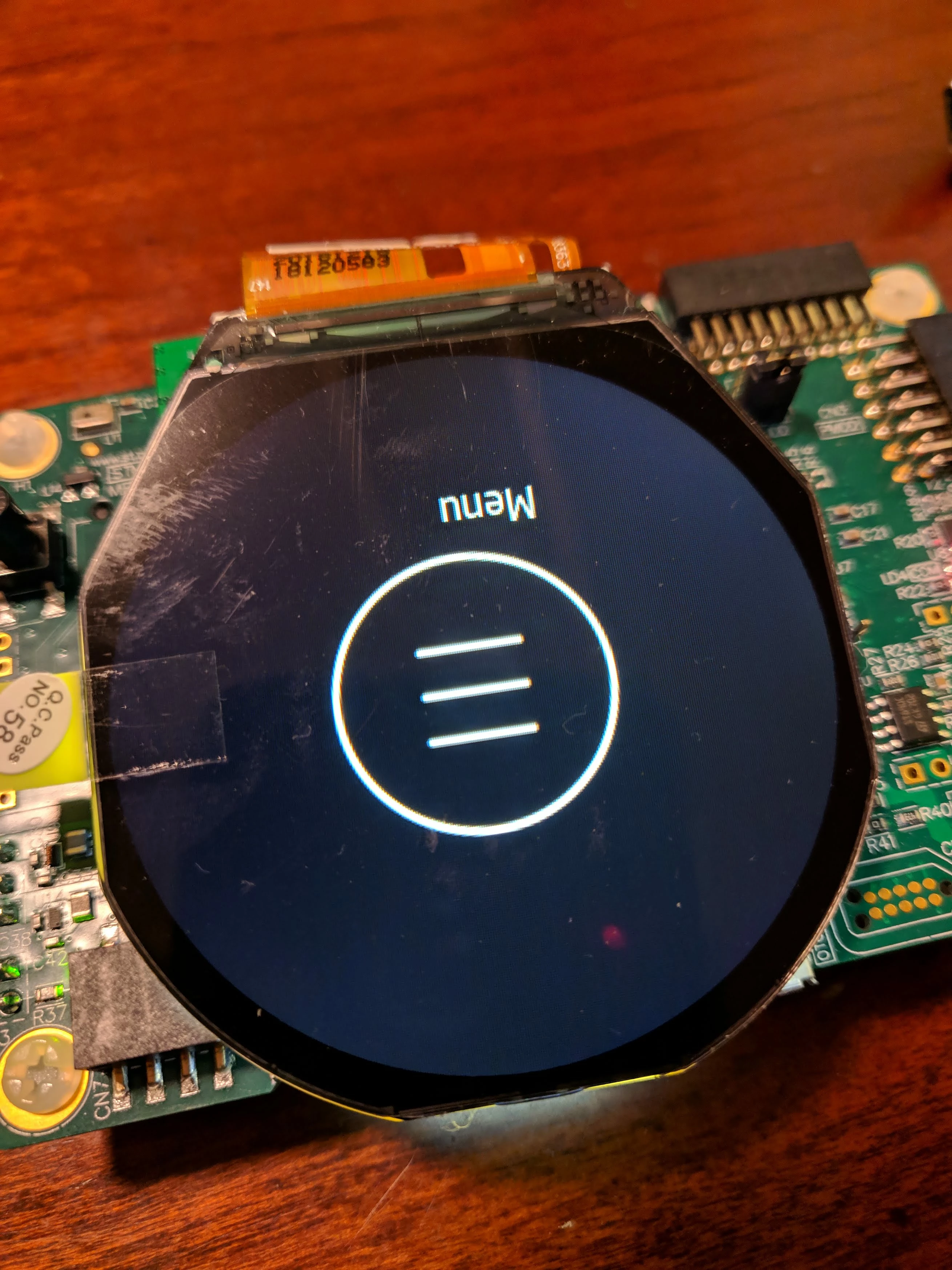

Du1
Du1Author
January 24, 2019
Success!!! Turns out there was a old value being programmed from the old 390x390 display.
