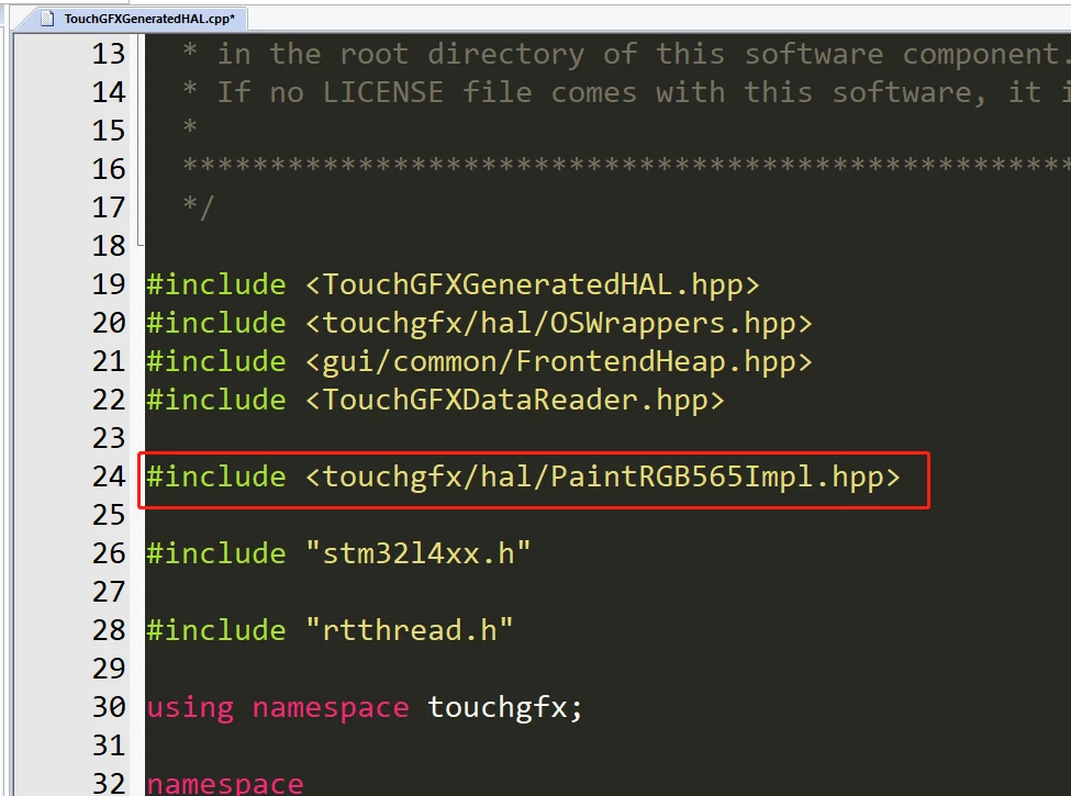

STM32L4R9 + touchgfx4.20 + MDK build error?
Error: L6218E: Undefined symbol touchgfx::paint::rgb565::lineFromColor(unsigned short*, unsigned, unsigned, unsigned char, unsigned) (referred from painterrgb565.o).
How to resolve?

Hello @zhuij.1​ ,
I tried to reproduce your error, but everything worked fine for me when I started a STM32L4R9 project from scratch, generated code for MDK-ARM in CubeMX and then generated code in TouchGFXDesigner.
Could you please try to delete your Middlewares>ST folder, then press generate code in TouchGFXDesigner again. After that, please try to rebuild your MDK-ARM project and let me know if you still have the same issue.

zhuij.1
zhuij.1Author
Jun 30, 2022 10:23 AM UTC

Hi @zhuij.1​ ,
If you have just upgraded touchgfx from an earlier version, it would be also worthwhile looking at:
https://support.touchgfx.com/4.20/docs/miscellaneous/known-issues
This references this type of issue.
