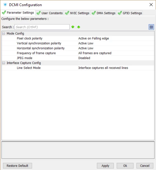

I did a "Clean Build" and "Build All" and I am no longer inside the Hard_Fault_Handler.
I am still getting NULL values in my "cameraBuffer[]" array.
Does anyone have any experience debugging DCMI and DMA?
I do not know why the following call is not putting data in the "camerabuffer[]" array (from main.c, line 166/167.
hal_status = HAL_DCMI_Start_DMA(&hdcmi, DCMI_MODE_CONTINUOUS, (uint32_t)cameraBuffer , CAMERA_FRAME_BUFFER_SIZE);
It seems that there is something not right with the stm32cubeMX linking DCMI to DMA, but I am not sure.
I am following the stm32L496G-Discovery as an example project, but it is not an identical match for saving to a USB drive.

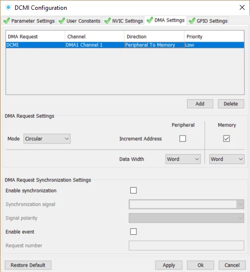

Inside the "HAL_DCMI_Start_DMA()" function, it calls a function called "DCMI_TransferSize()"
Should I be using 32-bit DMA transfers or 8-bit transfers? Does it matter?
I attached a picture of the stm32cubeMX DMA/DCMI configurations.
