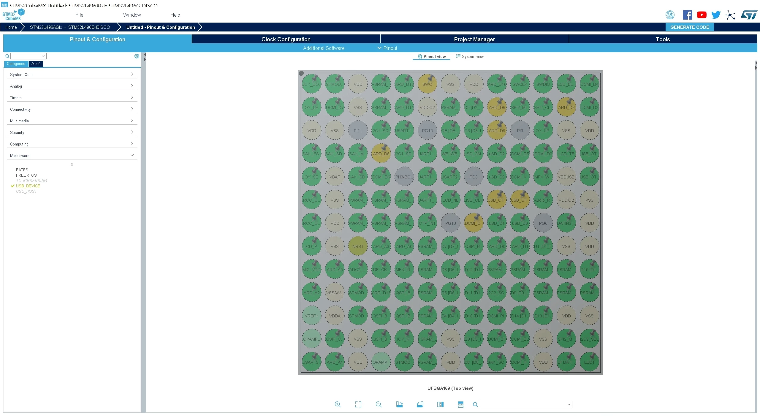

MuratUnal
Dec 27, 2019 7:31 PM UTC
Hello Martin,
We have same problem about touchgfx and Cubemx (STM32L4R9I project).
We started a project with STM32L4R9I-DISCO board template project from touchgfx. Same time we developed our own hardware with same MCU. Our own hardware is in board manufacturer for assembly now. We need to integrate STM32L4R9I-DISCO board project to our own hardware.
How can we do? I have some ideas:
Solution 1:
We can create a project from Cubemx without touchgfx. We can change GPIOs, UARTS, FMC, I2C....configurations according to our custom hardware and put the driver files in to the DISCO project manually. This is very painfull method and if possible, we dont prefer this method.
Solution 2:
if we have a touchgfx project and cubemx project (we know cubemx doesnt support touchgfx for this MCU yet) in the same folder structure, we can make some changes from touchgfx gui and compile or we can make changes from cubemx and compile.
We already did it from another project with STM32F746G-discovery kit (3.5" LCD). We started project with your template under touchgfx for STM32F746G-discovery kit. After that we developed our own board with 7" LCD. when we open your template folder, we saw cubemx *.ioc project file (with touchgfx disabled). And we started to change cubemx project according to our custom hardware and also graphical changes from touchgfx gui and compile both of them separately. It is working well.
if We do same thing for STM32L4R9I-Disco, we can easly adapt our own hardware and continue. But this time your STM32L4R9I-Disco template project doesnt have cubemx *.ioc project file. So it is difficult to use this method for us.
To better understand me, please create a new project for STM32F746G-discovery kit and for STM32L4R9I-Disco from touchgfx gui (V4.12.3) and check both projects folder structure. You will see one of them have *ioc file for cubemx.
Do you have STM32L4R9I-Disco template project which include cubemx *.ioc project file? In my case i guess *.ioc cubemx project doesnt need to have touchgfx support because you already put touchgfx inside the folder.
Solution 3:
Waiting cubemx support touchgfx for L4 series. :sad_but_relieved_face:
Unfortunately we cant wait now. So we need to continue solution 1.:sad_but_relieved_face:
Any another Solution ??:
Our do you suggest us any another solution?
