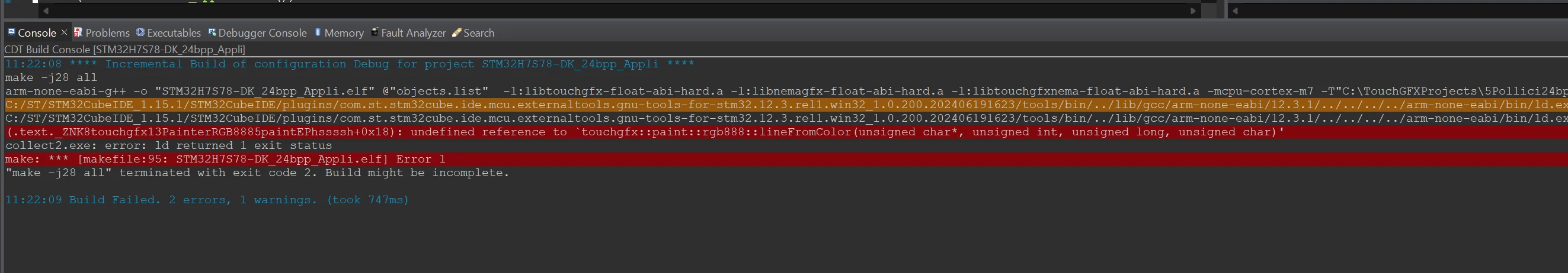

Filling in the automatically generated code, without any personal additions, and after regenerating the code with TouchGFX I get the following error:
undefined reference to `touchgfx::paint::rgb888::lineFromColor(unsigned char*, unsigned int, unsigned long, unsigned char)'
Which I fix by following the following link : https://support.touchgfx.com/4.20/docs/miscellaneous/known-issues.

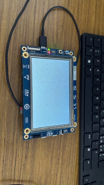

Fixed this I compile the code, load the firmware on my dk but the screen appears black (Backlight On but totally black).
Debugging and hitting the pause button the program is stuck in HAL_GPU2D_ErrorCallback as shown in the figure below.
Unfortunately, the values of the registers cannot be accessed from Datasheet because private.
How can I do to see correctly on my Discovery in RGB888 format?

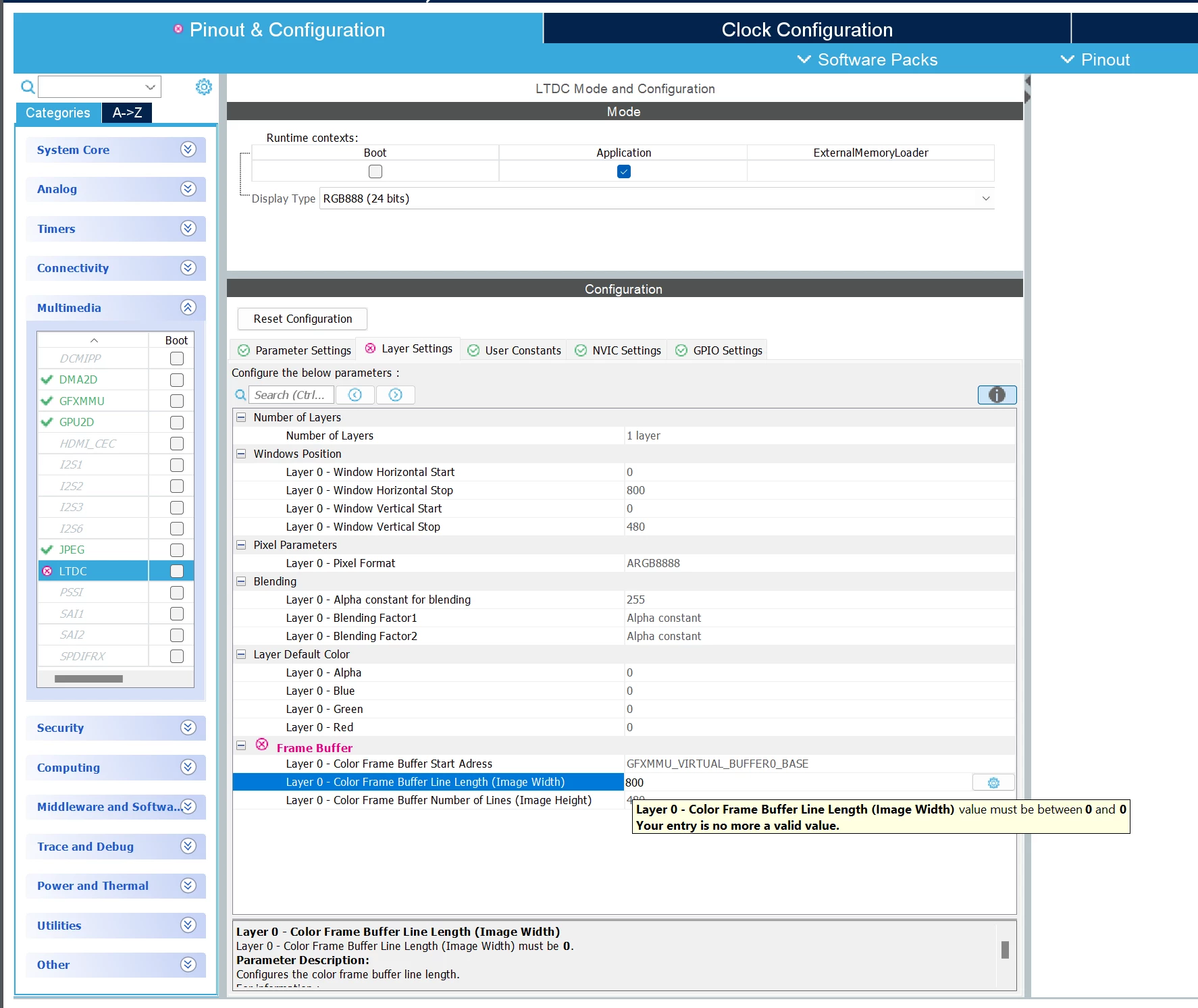

Meanwhile, opening the project on CubeMX I find the following error (error I find without having modified anything) see image "error" below.
Updated the code and simply doing the project build I find the error in image 2.
Once I fixed the error in image 2 via tutorial on known problems the screen appears to me as in image 3.

I suggest you to use the latest version of TouchGFX, STM32CubeIDE and STM32CubeMX.
The width cannot be between 0 and 0, I think the version of STM32CubeMX you are using is incompatible.
Have you tried to open TouchGFX Designer, create a new project, select the STM32H7S7-dk board in 24 bpp, flash and run from TouchGFX Designer?
