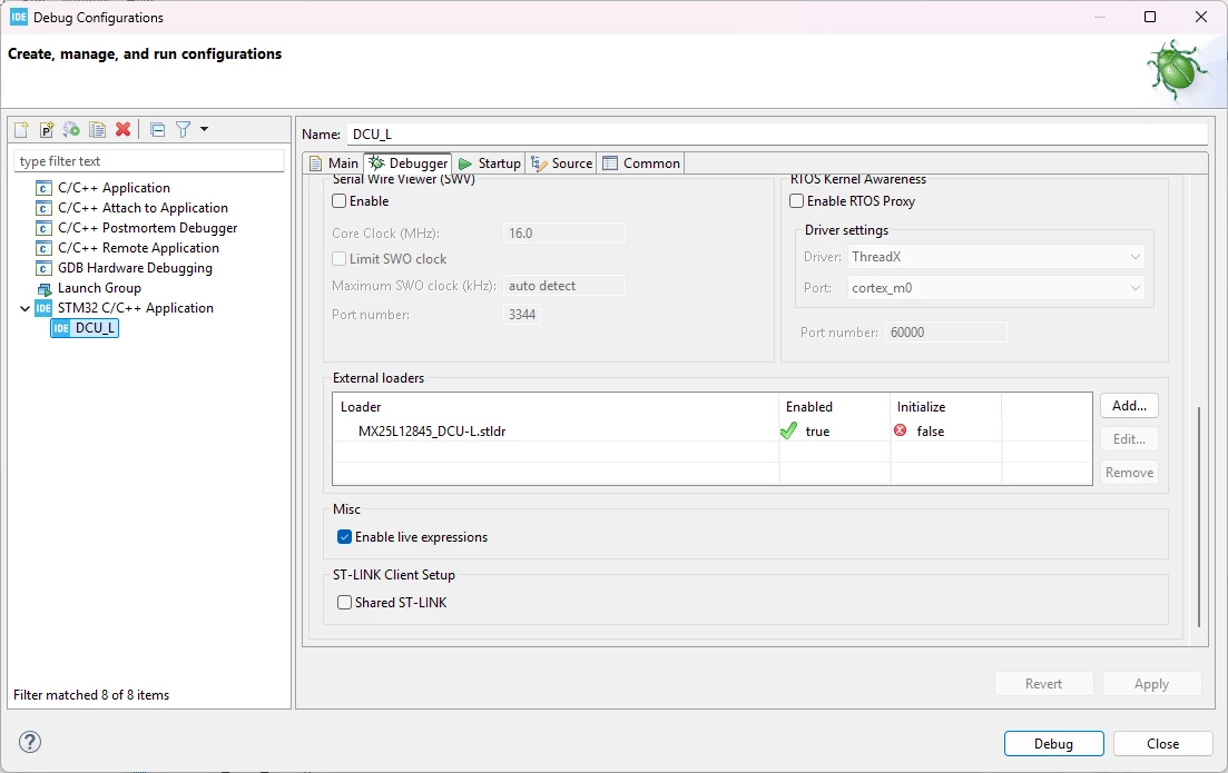

MHoll.2
Senior III
Feb 11, 2026 10:19 AM UTC
Not sure if this will help, but when You can programm the External Flash via CubeProgrammer, You have a working external loader for your flash. You have to tell the CubeIDE to use this Loader by selecting it in the Debug Configuration::
