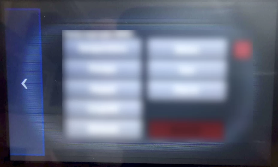

0693W00000QNu7wQAD.pngNotice the light ring around the screen content, also the horizontal lines - they are not there normally.

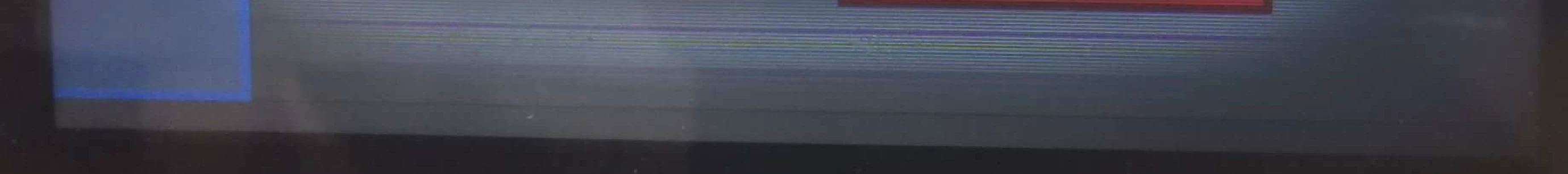

0693W00000QNu9YQAT.pngHere's the larger version of the bottom of the screen.
The picture was taken a few minutes after it happened. Earlier it looked far worse, the ring was solid white, the original content was barely visible, the whole screen blinked.
I don't know how to even reproduce it. I don't know if it would be even safe to reproduce it.

Looks more backlight/diffuser

I've seen this before when I connected a different screen to a board that was programmed to send initialisation code for another screen, same as you describe, got better over time after the correct initialisation code was added.
Usually the panel manufacturer will provide a sequence of commands to send to the screen on power up via SPI or whichever means, if I remember rightly some of these include voltage levels which will vary between panels.

I discovered WHY it happened the last time: STM32CubeIDE without any warning reset several GPIO pins, including LCD_RESET and LCD_BL. The bug is reproducible, I stumbled upon it again and this time I had no other changes on my git repo. So - disable those pins and the screen fryer is ready.
So - without those signals the screen seems to "burn out". It goes pretty quickly, fortunately not as quickly to cause problem in the time I flash the changes to the chip.
When it happened before, I just disconnected the LCD panel before downloading the flash update.
The good news is today my device survived over 20 minutes in this state and it seems there's no permanent damage.
