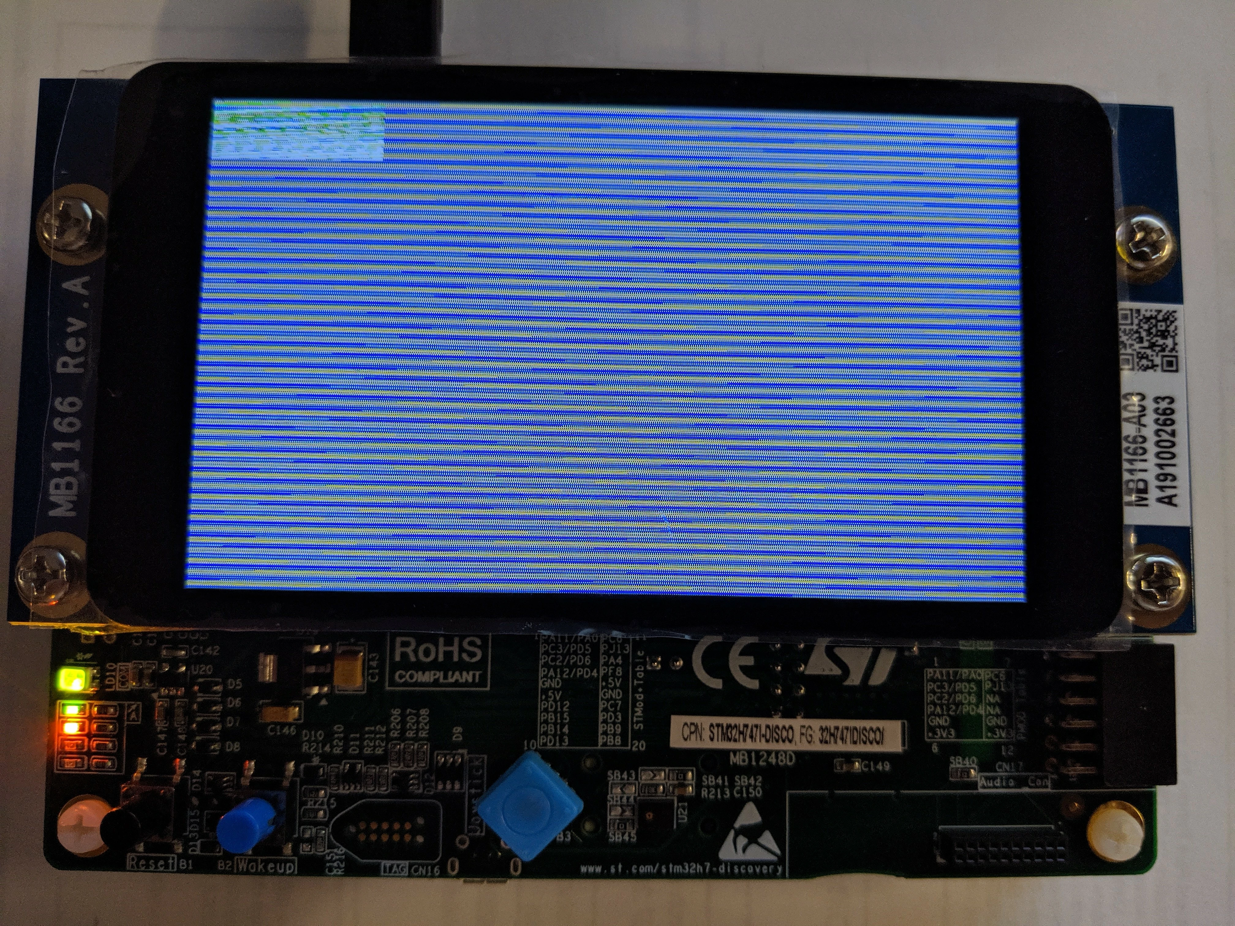

I generated a new Project with TouchGFX, I selected the Application Template (16 Bit) with a Blank UI. I placed a Button With Labelk in the left upper corner:
- Generate Code: "Code generation complete"
- Run Target: "An error occured during flash. Please make sure you have the right target connected."
I used the STM32 ST-LINK Utility and downloaded the File "...\My Application\TouchGFX\build\bin\initflash.hex" - the result can be considered in the appendix :(0690X000009Z23dQAC.jpg

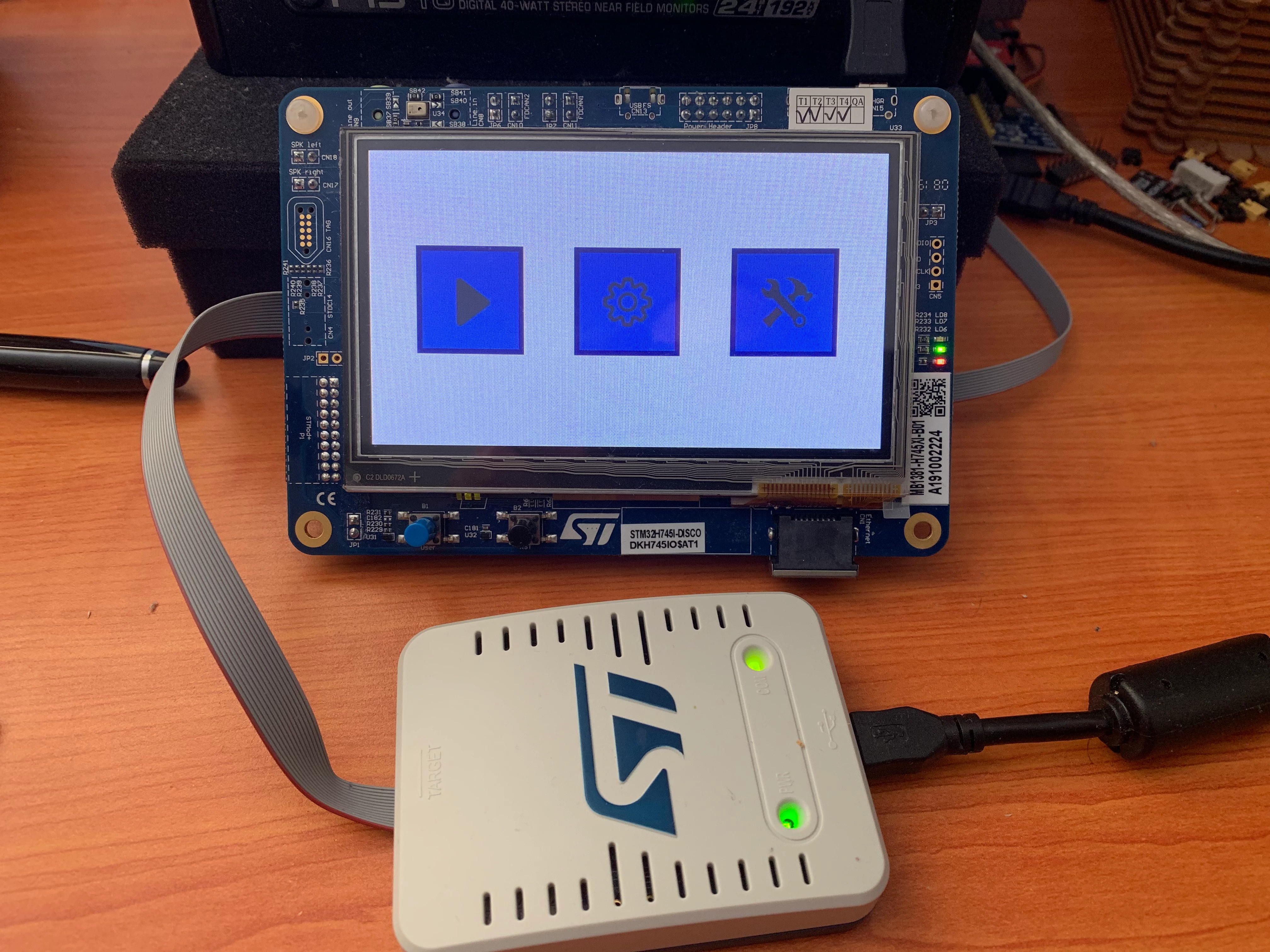

0690X000009Z297QAC.jpgHi, welcome to STM32. Dual core processors are not yet implemented in STM32CubeIDE. It will come but nobody knows when. I have got a STM32745i-Disco board and I have successfully downloaded a test screen from TochGFX designer. To develop code for both cores you have to use System Worbench (see picture TouchGFX CM7, CM4 blinking led) .
For the STM32H747 I have created a TouchGFX designer project (attached). Try downloading the target.elf file. Building code from command line 'TouchGFX 4.10.0 Environment'. Change folder to TouchGFX and run 'make -f ../gcc/Makefile -j8' and 'make -f ../gcc/Makefile -j8 clean'.
