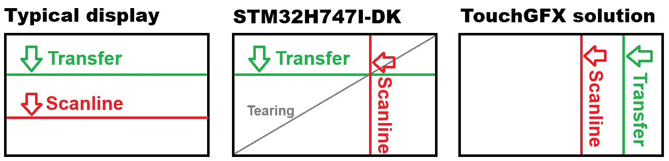

I am using STM32H747I-DISCO with MB1166-A09 (NT35510) and Zephyr + LVGL with MIPI DSI Video Mode.
I am facing a diagonal/slanted tearing line when the display is configured in landscape mode.
  • Portrait mode: works correctly
  • Landscape mode: diagonal/slanted tearing appears during screen updates
  • Hardware: STM32H747I-DISCO + MB1166-A09 / NT35510
  • Software: Zephyr + LVGL PRO
I have found several related discussions about this issue, but I haven't found a clear solution for landscape DSI Video Mode.
Is this a known limitation/issue with the display/DSI configuration? Is there a recommended solution for running this display reliably in landscape Video Mode?
Any guidance from ST or anyone who has solved this would be greatly appreciated.
2 replies
MM..1
August 24, 2026
This is normal for MADCTL switch only memory adressing. Driver require too scan switch and this isnt one reg.
September 3, 2026
Hi Shahima,
