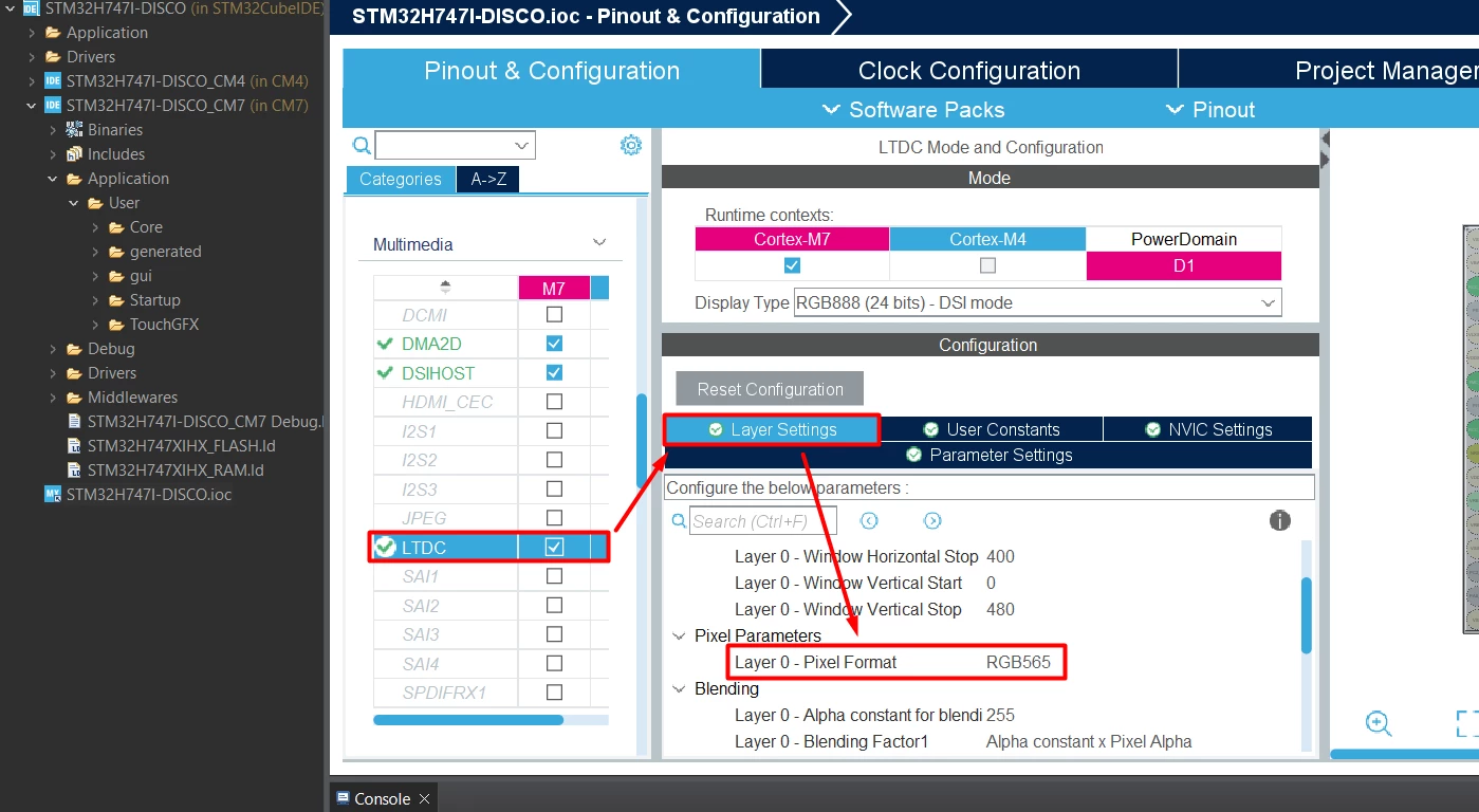

I have a stm32h747i-disco board. When I create a touchGFX project by using touchGFX designer template, it works perfectly. Its color depth is 24-bit and when I change color depth to 16-bit(RGB565), it fails.

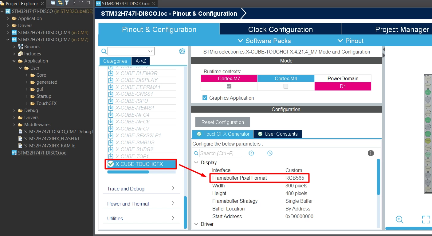

To change color depth to 16-bit, firstly I am changing Framebuffer Pixel Format section to RGB565 like in the below:

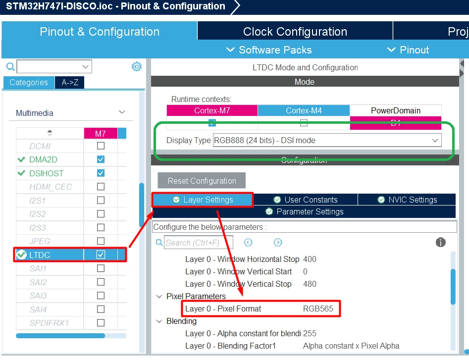

Then I am changing the Layer 0 - Pixel Format section to RGB565 like in the below:
Before pressing to cubeMX save button, I am deleting target folder. After that, pressing cubeMX save button. Ref: https://community.st.com/t5/stm32-mcus-touch-gfx-and-gui/8-bpp-color-palette/m-p/221627

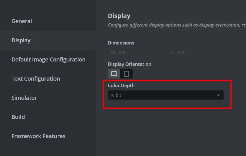

Later, I am opening touchGFX project and as you can see it is 16-bit now.

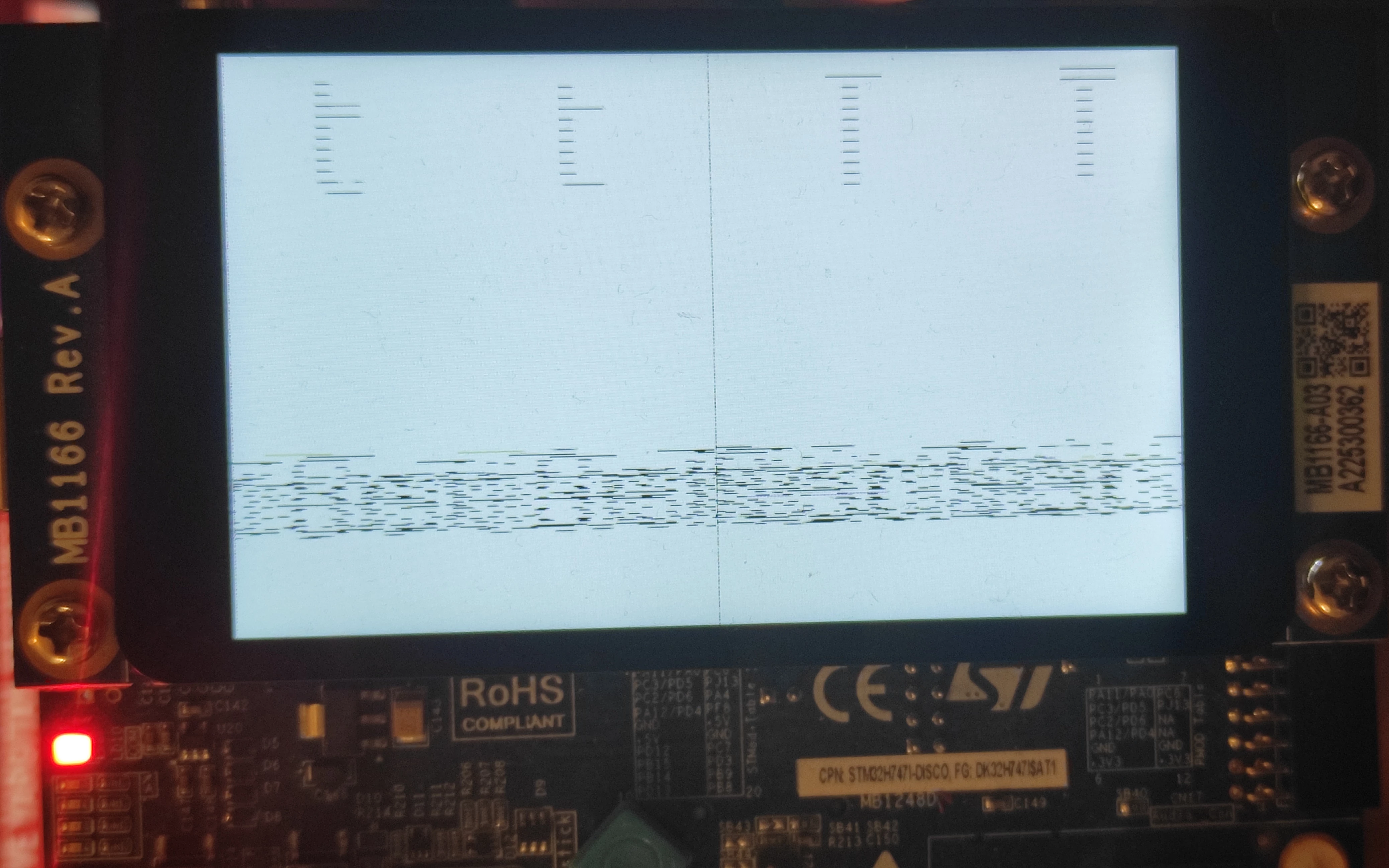

Then I am pressing "generate code" button and finally, i'm downloading new 16-bit project to stm32h747-i disco but it shows me this screen when I try to use 16-bit color depth. It fails.

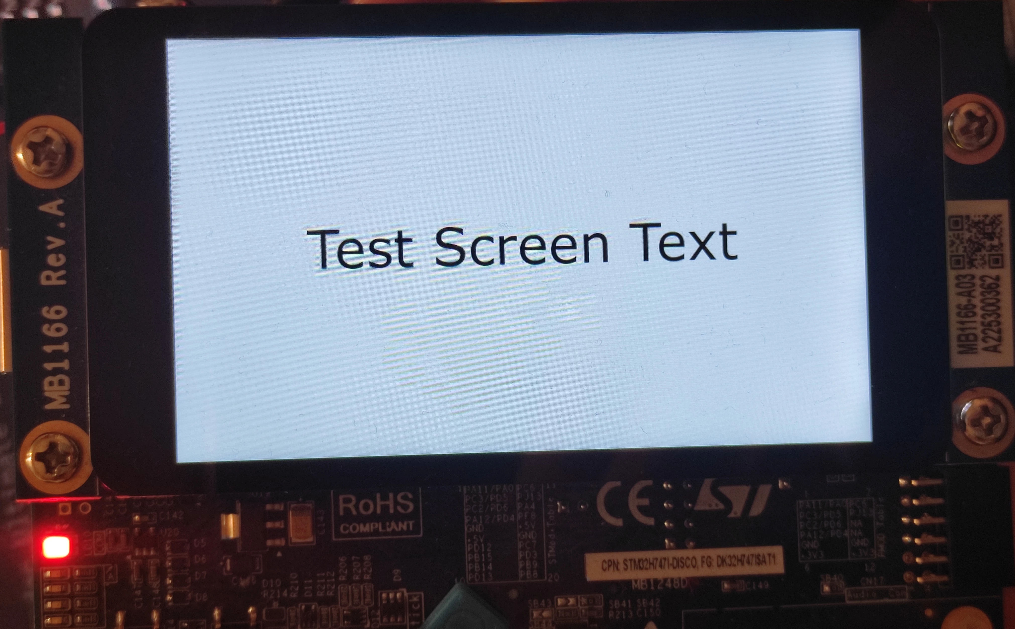

However, when i use 24-bit color depth, it shows me this screen as expected and works without any problem!!!

Fix DSI transport mode so data funnelled from LTDC appropriately. The display controller (on the screen/panel itself) also needs to expect the bit, byte, and lanes in the mode you're pushing over the wires.
Tesla DeLorean
Guru
Dec 26, 2023 7:51 PM UTC
Settings need to be coherent end-to-end. All of them..
So double check DSIHOST, LTDC, and Panel itself all have common expectations for data from the frame buffer.

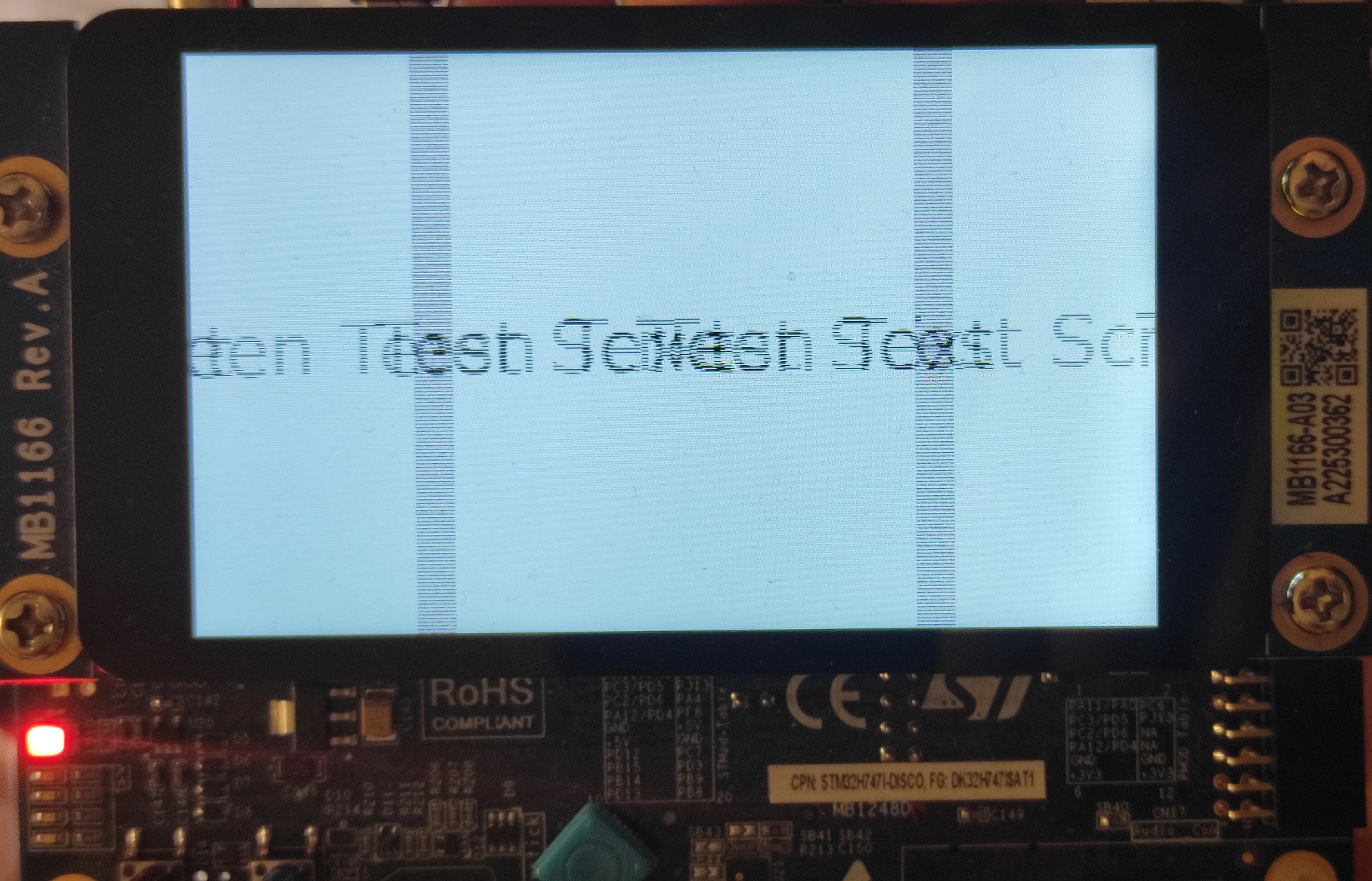

As your suggestion, I cancelled point 3 and point 4. Then I found LCD configuration line in the main.c ( in the MX_LTDC_Init()). I changed
OTM8009A_Init(&OTM8009AObj ,OTM8009A_FORMAT_RGB888, OTM8009A_ORIENTATION_LANDSCAPE)
to
OTM8009A_Init(&OTM8009AObj ,OTM8009A_FORMAT_RGB565, OTM8009A_ORIENTATION_LANDSCAPE)
To summarize, I changed ;
1-) TouchGFX Framebuffer Pixel Format to RGB565
2-) Layer 0 Pixel Format to RGB565
3-) OTM8009A_Init parameter to OTM8009A_FORMAT_RGB565
Unfortunately, it didn't work. Am I missing something?

In CubeMX check DSIHOST -> Color coding if not already. If didn't help, maybe try disable DMA2D for now - I'm just guessing.

Dec 28, 2023 3:32 PM UTC
Well, I'd try disabling TouchGFX and fill the framebuffer with some simple pattern in RGB565 mode to make sure the display is showing what is expected and the hardware settings are ok.
