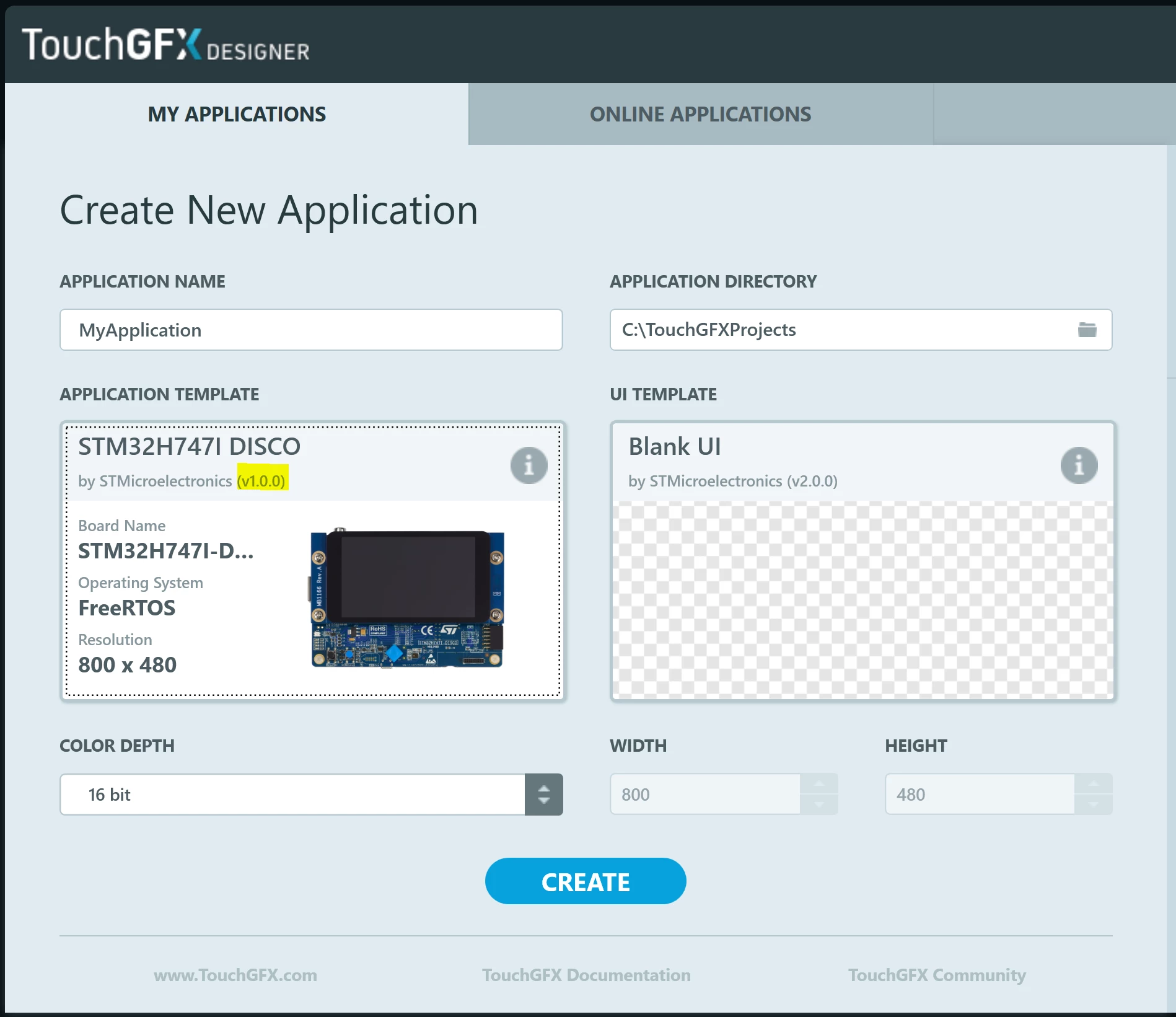

Good morning,
I'm using a discovery board STM32H747-DISCO.
Why, Touchgfx don't generate the project .ioc, to import in CUBE IDE?
Instead, if I select another board (for example STM32F7508-DK) , when generate code, the compiler buil also .ioc file.
I have also installed the last version 4.14.0 of TouchGFX, but the problem persist.
Thank you

Alexandre RENOUX
Visitor II
August 14, 2020
If you look closely when choosing an Application Template you can see a version. For H747-DISCO, the version is 1.0.0 as you can see highlighted on the picture below.
For an Application Template to be with an .ioc file, meaning to be compatible with TouchGFX Generator inside CubeMX, this version must be superior or equal to 3.0.0. Therefore, it is normal that a version 1.0.0 has no .ioc file.
The reason why there is no 3.0.0 version for the H747 is because CubeMX does not yet support the dual core of this MCU, therefore it is not possible to configure it in CubeMX. I do not know the schedule for this CubeMX update but it is to be done in the foreseeable future.
/Alexandre

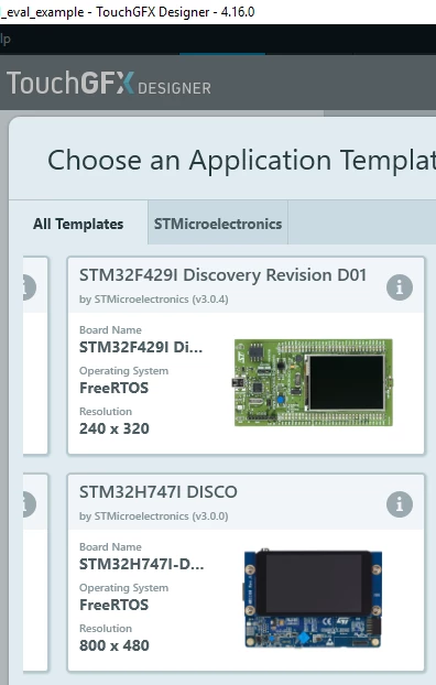

Ctoma.1
Visitor II
May 14, 2021
it seems that also with version 3.0.0 for H747Disco there is no the possibility to create *.ioc file. Can you confirm that?
I'm using TouchGFX Designer 4.16.0.
0693W00000AOKxzQAH.pngThank you
Romain DIELEMAN
May 14, 2021
Yes the ioc has not been implemented in the v3.0.0 as we wished due to issues with STM32CubeMX and dual core support. It will be with the next version we are working on (most likely 3.0.1). It should be release along TouchGFX 4.17.
/Romain
