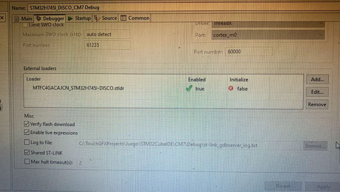

I have a STM32H745i that if I want to load the code by USB it works OK if the project is from STM32CubeIDE (1.16.0) but if the project is imported from TouchGFX it presents the following error when I want to load the code:
I read a post from someone who had this error but I don't understand the “ExtMem_Boot” step so I just set up the external loader but it didn't work.
any idea what it could be?
Best answer by mƎALLEm
I reproduced the behavior and seems you didn't select the correct External Flashloader:
The correct one is: MT25TL01G_STM32H745I-DISCO.stldr
I was able to upload the external QSPI after setting correct flash loader.
Hope it does answer your question.

Hello @Maximiliano ,
It seems you have not mentioned the file to use as external loader.
This can be easily fixed.
  1. Open STM32CubeIDE
  2. Right click on your project
  3. Go to Debug as
  4. Click on Debug configurations...
  5. Select your project again
  6. Open the Debugger window
  7. Under External loaders, click on Add
  8. Browse to find your stldr file (usually located in the gcc folder)
This should fix your problem.

September 16, 2024
Good morning Gaetan and thank you for your reply,
I had tried what you mentioned but it doesn't seem to work, I don't know if you meant that the file is inside the project folder. I selected the one that seemed right for my model from the options that the compiler gives me, it looks like this:
but it throws the same error.
