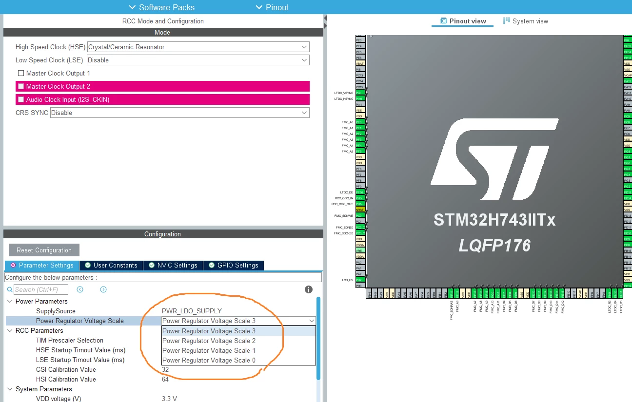

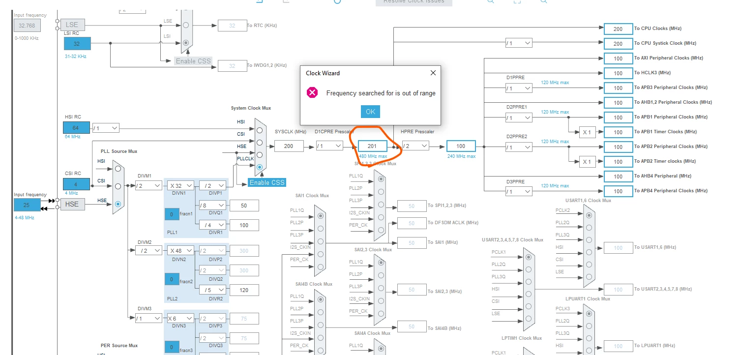

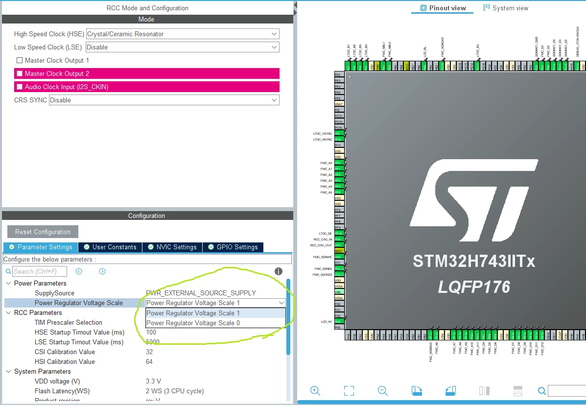

also, I create two different cubeMX files and encounter two different menu
also, the clock configuration doesn't get a clock speed of more than 200Mhz. I attached an image to clarify problem.

Can you confirm the two projects are created from scratch and have the same configurations but show different options now.only for the power voltage scale.

The value of the "SupplySource" setting differs in those same screenshots... And the "Product revision" setting also has an impact on the maximum frequencies.

Hi, I've just experienced a simillar problem. In my case, Cube generated RCC_ClkInitStruct.AHBCLKDivider = RCC_HCLK_DIV1; instead of RCC_ClkInitStruct.AHBCLKDivider = RCC_HCLK_DIV2; I have been quite intensively playing around with everything so it probably went mad. After clicking correct values to clock configurator once again and pressing alt+K to force code generation, the problem was solved.
