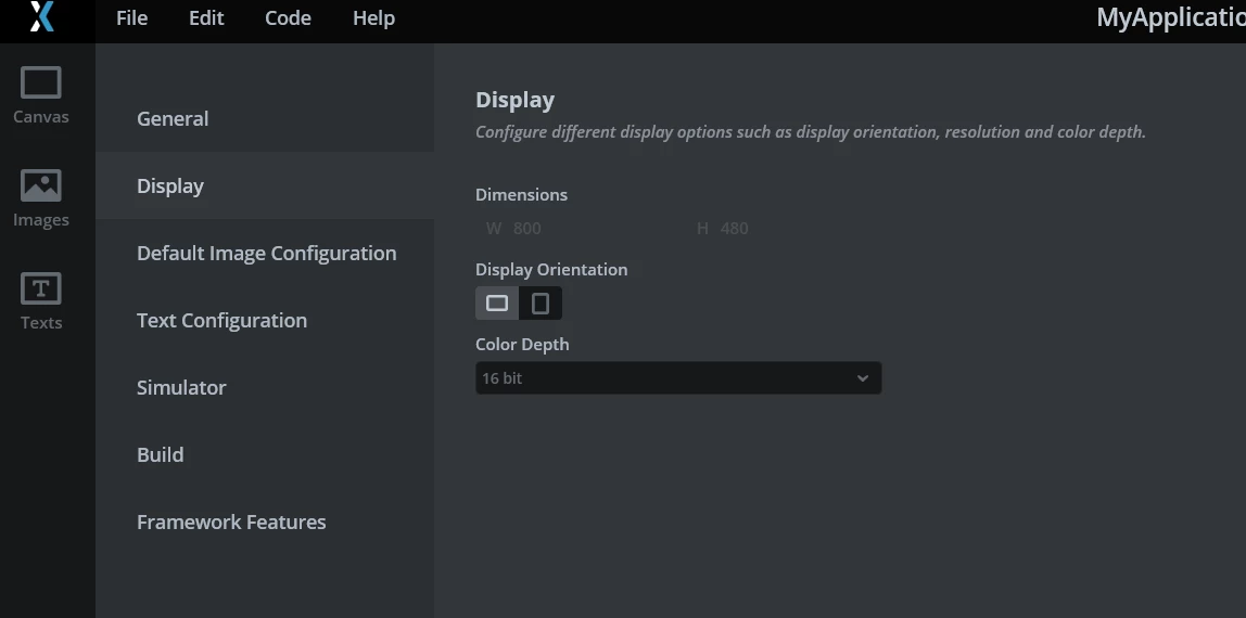

Hello, i have stm32h745i for my project but unfortunately the SDRAM itself is not enough to handle my gui program.I use lvgl and squareline studio to make gui. I have thought that maybe if i can reduce the color depth from 32 to 16 will reduce my memory usage. Is it possible?

I have tried TouchGFX and i need some tools from squareline studio that not exist in touchgfx, so i choose touchgfx. basically it is mostly the same. How can i change 32 depth to 16 in touchgfx? what should i change?

Hello @BAl K.1 ,

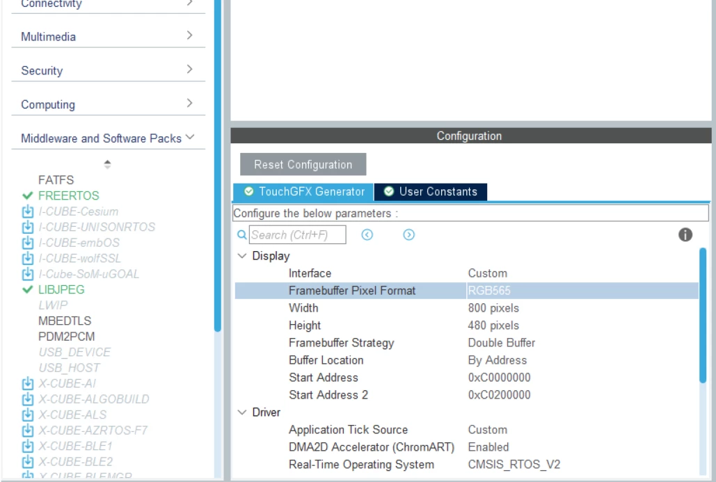

In TouchGFX that's pretty simple actually, it uses the Framebuffer Pixel Format you set in the STM32CubeMX project (You need to have the X-CUBE-TOUCHGFX software pack of course).
In the "Config" panel in TouchGFX Designer, you'll see then the Color depth associated to it, and whenever you'll generate code, it will take in account that value.
