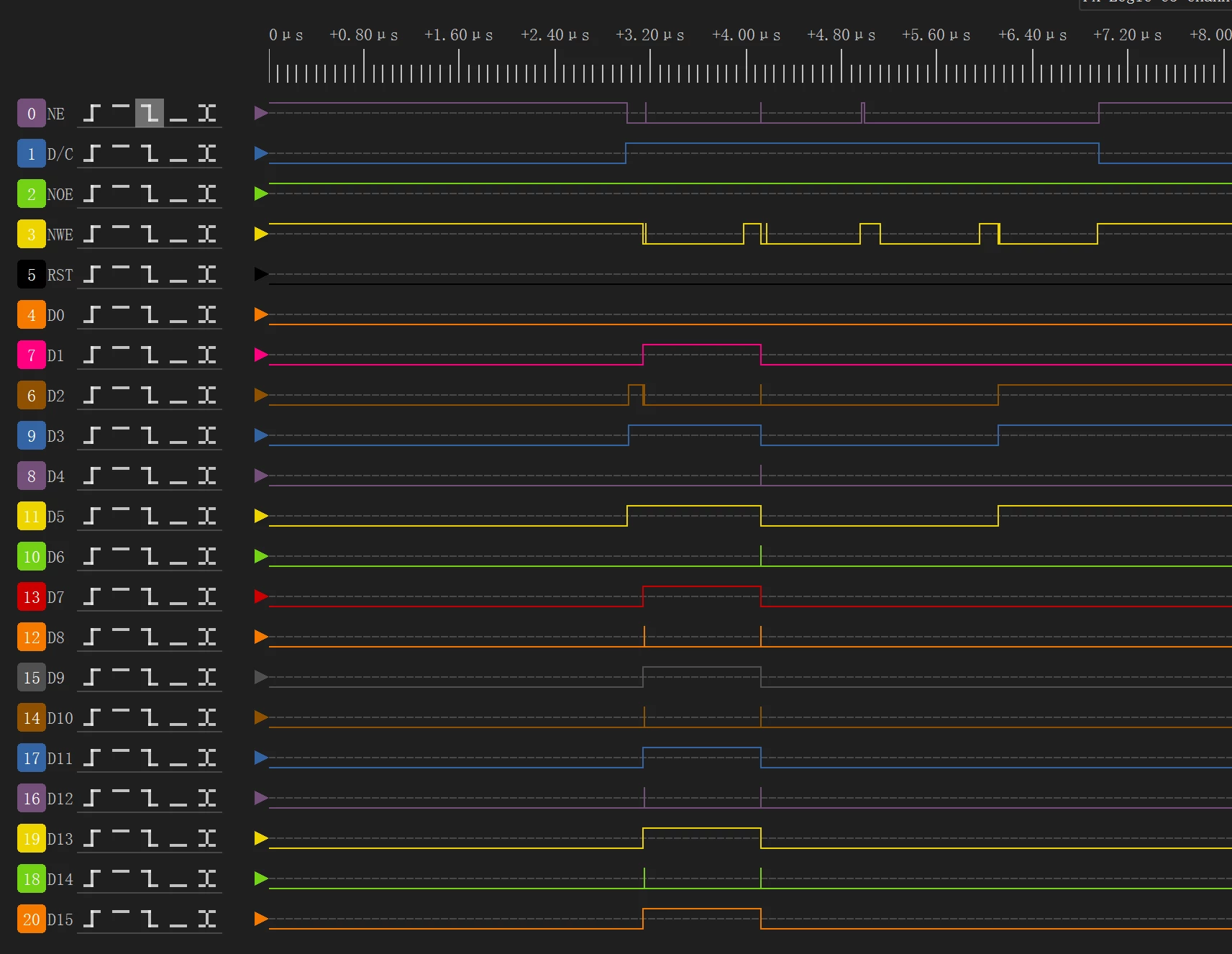

STM32H743VIH6 FMC send eight bytes in one time while I send 2 bytes
While I use the STM32H743VIH6 FMC to drive the ST7789V TFT-LCD via a 16-bit 8080 interface, it's quite strange that even though I only send a half-word, the result is that it sends four
code is

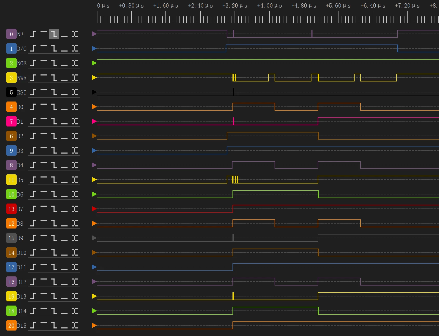

but when I send like
*(volatile uint64_t *)0x61000000 = 0xAAAABBBBCCCCDDDD;
the signal looks just like this
I still can't find a way to control FMC to send one half-word....

OK, I found the result...
FMC default mapping uses 0x60000000 as the address, but this is normal memory in the Cortex-M7's MPU unit, and as a result, it is 64-bit.
Just remap it to 0xC0000000, and the problem will be solved.
