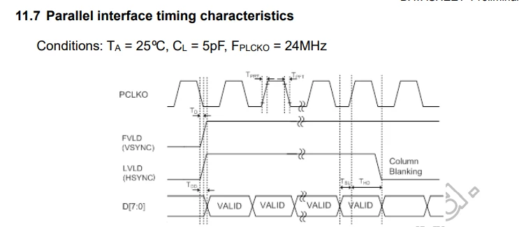

STM32H743VGHX DCMI interface: Hi Everyone, 1. We are not getting Frame Event call back 2. Getting line event call back but no data is updating to the valid RAM location (0x30000000)
1. I had an issue with DCMI 8-bit wide parallel data bus) with Bayer RGB image sensor (HM0360)
2. With hardware synchronization we are able see the VSYNC and HSYNC on the logic analyzer as mentioned in the attachment.
3. I also attached the Parallel interface timing characteristic diagram for camera.
What might be the problem for not getting the frame event call back.
Configurations on the controller side as per the camera specifications.

Make sure that the VSYNC, HSYNC and PIXLCK are well configured.
I recommend that you refer to this AN5020 Digital camera interface (DCMI) on STM32 MCUs
that helps you on DCMI configuration.
