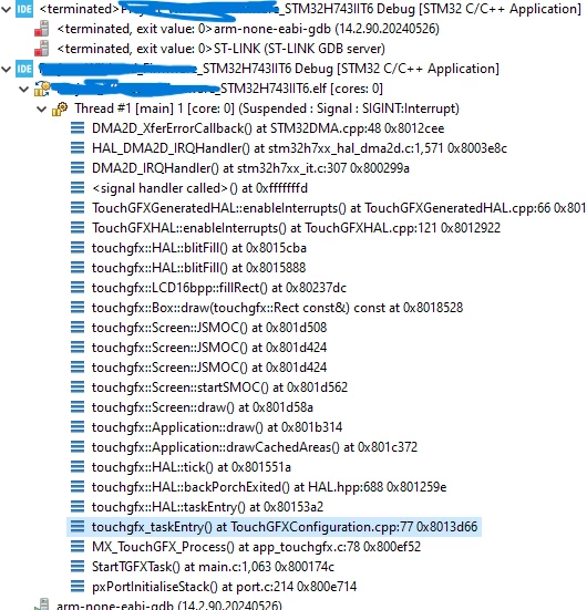

I am running into issues with a custom PCB based on STM32H743IIT6.
Using MT25QL512ABB8ESF-0SIT QSPI flash IC for external memory and IS42S32400J-6TLI as SDRAM,  with an LCD screen. Using TouchGFX.
I am getting this error. Any ideas what could be causing it?
Thank you in advance!
Best answer by AEng7
I ended up solving this issue by just using the STM32H743IIT6 internal flash and SDRAM for the framebuffer.
