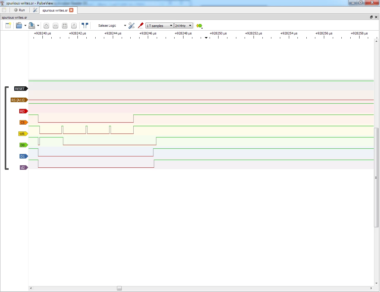

STM32H743II FMC + 8080 LCD spurious writes
Posted on April 20, 2018 at 11:55
I'm interfacingSTM32H743II with 8080 parallel bus LCD. I configured FMC in CubeMX as LCD Interface with 16bit bus and A11 as R/S pin. However I've run into problem with writing commands/data into LCD. A single uint16_t write under 0x68000000 address results in 4 writes to memory, out of which first write is valid data, and rest are 0, as seen on logic analyser snapshot.
Write is performed by following code:
#define COMMAND_POINTER 0x68000000
#define DATA_POINTER 0x68001000
static uint16_t * command = (uint16_t *) COMMAND_POINTER;
static uint16_t * data = (uint16_t *) DATA_POINTER;
*command = ILI9341_SWRESET; //software reset�?�?�?�?�?�?�?�?�?�?�?
I also tried HAL_SRAM_Write_16b(), but result is the same.
These writes basically compile to strh (Store register halfword) instruction, and executing this single instruction causes 4 write accesses to LCD. After little investigation i noticed, that writes under incremented address, for example 0x68000002 causes valid data only in second write operation, write under 0x68000004 causes valid data only in third write and so on. It's like FMC tries to write whole 64bit memory block at once.
ICache and DCache are disabled, i tried to disable FMC write FIFO, but it doesn't change much. Needless to say this FMC behaviour throws off communication with LCD.
Am I not taking some detail into account? i would like to avoid bitbanging LCD signals or changing HW design.

I solved this problem by remapping fmc SRAM to 0xC0000000;
HAL_SetFMCMemorySwappingConfig(FMC_SWAPBMAP_SDRAM_SRAM);
Why this works? Memory under 0xC0000000 is accessed as Device memory, as opposed to memory under
0x60000000
accessed as Normal memory. 'Normal memory allows the load and store of bytes, half-words and words to be arranged by the CPU in an efficient manner (the compiler is not aware of memory region types)'. You can refer to AN4838 and AN4839 for more information.

IMO changing this area to Device just covers some other adverse mechanism. While the processor is allowed to rearrange accesses in Normal area in order to optimize, it's not OK to write outright incorrect data! (multiple*reads* would still be OK).
CDew.1
May 6, 2020 9:54 AM UTC
From what I understand, all the writes are correct. The CPU is assuming that the device, to which its writing, has address lines A2..A1.
These four 16-bit writes, of which only the first contains the "correct" data, represent the writing of one 64-bit cacheline to RAM.
If this had been addressable memory, the address lines A2..A1 would have gone through the values 00, 01, 10, and 11, writing to 4 separate 16-bit words.
(I don't know whether those address lines are, or can be, brought out to pins, but they are not on the logic analyser output.)
It's not unreasonable that the CPU must be told that this particular address range does not contain normally-addressable memory, but instead contains 16-bit IO registers with semantics which differ from those of memory.
