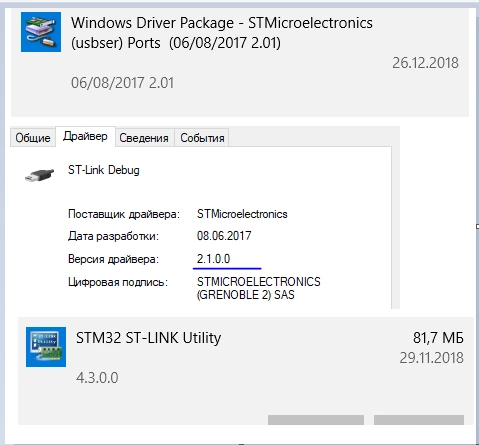

Hi. Can you share the details of which ST-LINK update you have applied and tested?
feelingoflight
Dec 28, 2018 3:48 AM UTC
STM32 ST-LINK Utility v4.3.0.0
STLinkUSBDriver.dll  v5.1.0.0
ST-LINK_CLI.exe    v3.3.0.0
Firmware Version: V2.J32.M22 STM32 Debug+Mass storage.

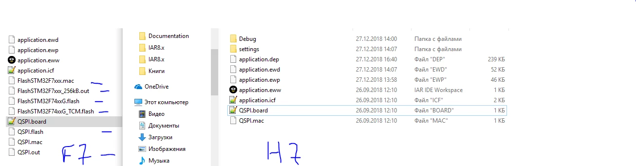

But i think that problem in generating some memory files, because when i try to flash firmware from IAR,
it shows error "FlashSTM32H7xxx_CM7.flash file was not found". Way to this file is containing in "QSPI.board" file. And "FlashSTM32H7xxx_CM7.flash" is not present in EWARM folder,
unlike "QSPI.board". When i try to use default IAR's flashloader files, it flashes, but do it wrong.
And for example look at comparsion generated STM32F7 and STM32H7 folders. STM332F7 board file contains ways to ".flash" files, which are presented in IAR folder.
Mon2
Senior III
Jan 1, 2019 2:21 PM UTC
Which ST-LINK update have you applied?
Can you try again after upgrading the following tool?
STSW-LINK009 2.0.1
https://www.st.com/content/st_com/en/products/development-tools/software-development-tools/stm32-software-development-tools/stm32-utilities/stsw-link009.html

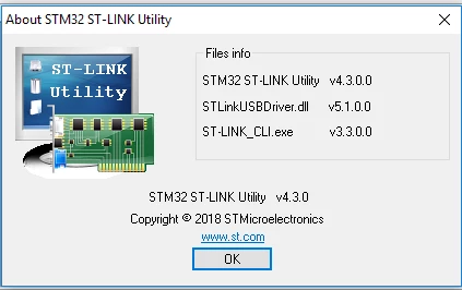

Martin KJELDSEN
Principal III
Jan 9, 2019 7:30 AM UTC
Hi @feelingoflight​,
It does look like an incorrect version. When you call make with the "flash" option, it simply makes a call to the ST-Link CLI and if your version does not have the right support (both internal flash and external) you'll get that message "No elf loader found".
Could you try showing me the "About" window from your ST-Link GUI ?
feelingoflight
Jan 9, 2019 8:32 AM UTC

Juan Delgado
Jan 27, 2020 10:13 AM UTC
I had a similar problem using STM32F746G-DISCO with new TouchGFX 4.13.0 version.
