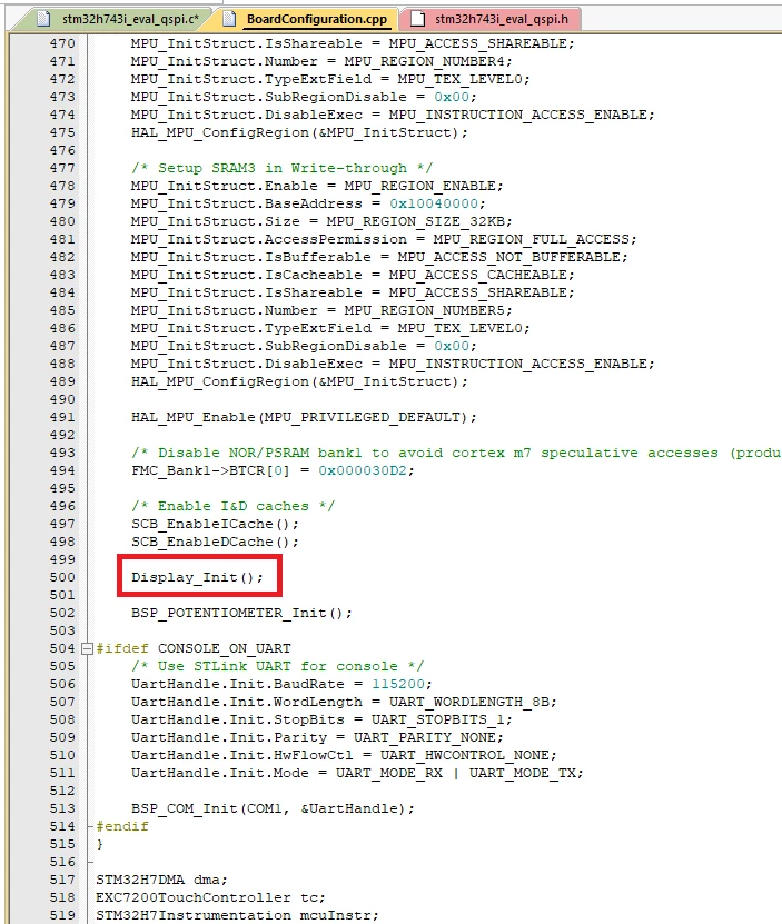

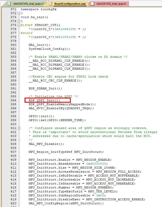

I think we're discussing something similar in another thread. Are you saying that neither QSPI_Init() or Display_Init() are being called?

Yes it only call
QSPI_Init()
Display_Init()
So LCD only light but no data read from QSPI.

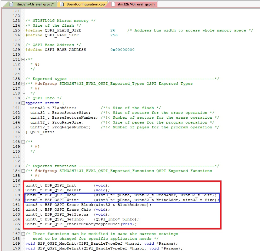

So I wanto know Where should I call BSP_QSPI read() function?

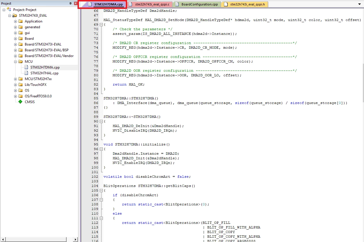

Something you can do is check your STM32xxDMA.cpp class and break in fillRect() - This is the DMA occupying its queue with blitops if you have images that can be moved from qspi to framebuffer. You should find that these blitops have a source pointer - And you can check against your map file to verify that it's trying to transfer your image.

Hi Martin
You mean STM32H7DMA.cpp
But I don't find fillRect() function
So I need to include which header file to use fillRect() function?
You mean I can use DMA to draw the photo in my QSPI?
