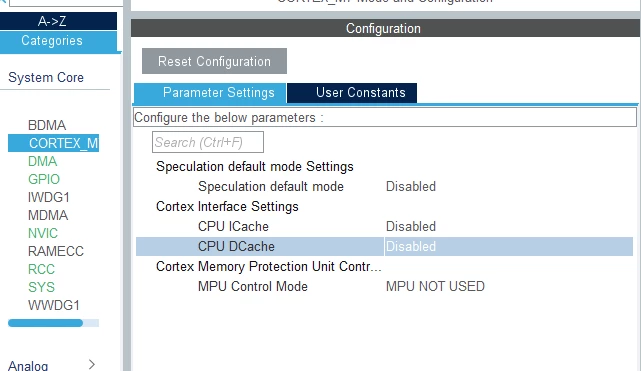

MRoso.1
MRoso.1Author
Jun 22, 2022 2:06 PM UTC
Hi, @Imen DAHMEN​
I made the necessary changes in the STM32H743ZITX_RAM.ld file and the DCcache option in STM32CubeIDE was already disabled.
