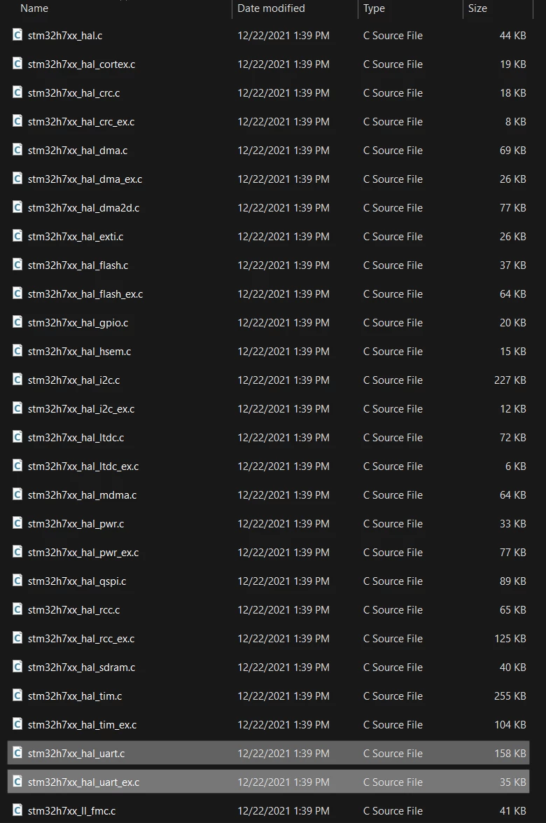

I enabled a UART peripheral in my touchgfx project. When I ran the project in STM32CubeIDE, it gave an error saying the HAL_UART_Init function was undefined. When I checked
${ProjectDir}\Drivers\STM32H7xx_HAL_Driver\Src
There were no HAL library files, so I pasted them in the folder:
This allowed STM32CubeIDE to compile and run the program. However, when I try to "Run Target" in TouchGFX, it gives the following error:

It seems TouchGFX is looking for the library files in a different folder than STM32CubeIDE, because it isn't compiling stm32h7xx_hal_uart.c
Am I overlooking something? Thanks for the help.

Your steps isnt standart.
  1. Paste files isnt way howto regenerate project , but can work ofcourse
  2. Run target in IDE use IDE CDT build, but run target on TGFX use makefile build, that isnt updated with new files.
Better is dont use run target on TGFX after IDE MX reconfig, or change commands in TGFX for run target...
