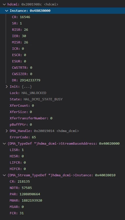

When HAL_DCMI_IRQHandler triggered I got:
So for DCMI I have in MISR register DCMI_FLAG_OVRRI = 0x02 and for DMA in LISR register DMA DMA_LISR_FEIF0 = 0x01.
FIFO treshold DMA_FIFO_THRESHOLD_HALFFULL without burst DMA_MBURST_SINGLE no effect.

waclawek.jan
May 26, 2020 11:21 PM UTC
Conflict with LTDC sound like a plausible reason, but on second thought, I wouldn't be surprised if it turns out that DCMI into SDRAM is simply not plausible at all, even without LTDC getting into way.
Let's put it this way: what's the incoming data rate to DCMI? Is there enough buffering in way (in DCMI itself, in DMA's FIFO, in FMC) to hold data for the longest SDRAM/FMC latency (probably the SDRAM refresh)?
