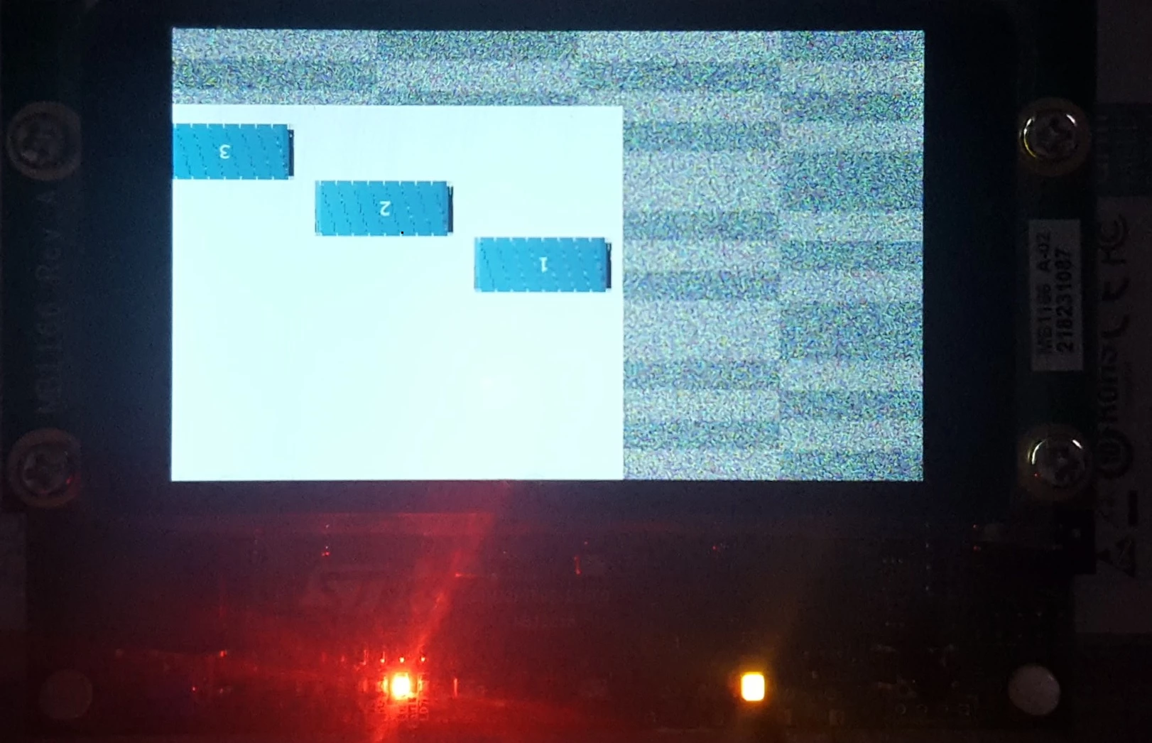

Hi Martin,
i tried to run the following tutorial by using the cubemx plugin in stm32cubeide.
(https://touchgfx.zendesk.com/hc/en-us/articles/360020208091-Configuring-STM32F769I-DISCO)
I created a minimal gui with touchgfx by running touchgfx form inside the plugin.
To run into the GRAPHICS_MainTask i had to disable the MX_ETH_Init(), MX_SDMMC2_MMC_Init() and the MX_WWDG_Init() function.
You can see my final result in the picture. But the screen is blinking, i think the program is running into the watchdog.
And the content is rotated 180 degrees.
FSTKMARO
December 4, 2019
Hi, I am also having trouble with the 769 using TGFX, can you tell me how did you change the *FLASH.ld" file to account for QSPI memory size and enabling? The instructions in the tutorial that you posted, which is the same one I have been following, only address this for EWARN and not for CUBEIDE. You seem to have gotten farther than I have with this board so I wonder how you got there. From what the picture show, you should double check the settings for the layer in LTDC. While you are there, you may want to check the DSIHOST settings. Your result seem to have a memory config problem. Thanks
