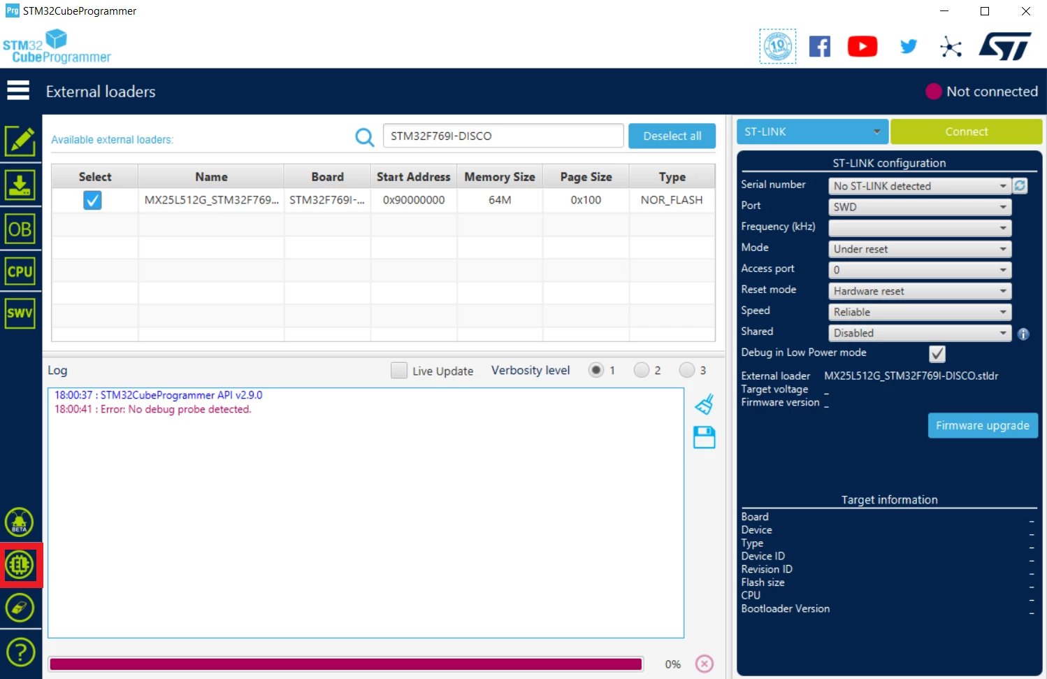

Houda GHABRI
Jan 12, 2022 5:17 PM UTC
Hi @JTurn.2​
I wonder if you selected the adequate External Loader for your board ?
0693W00000HrRPHQA3.pngHouda
JTurn.2
JTurn.2Author
Jan 16, 2022 11:29 AM UTC
Hi Houda,
I have already selected the adequate External Loader and the result is the same.
