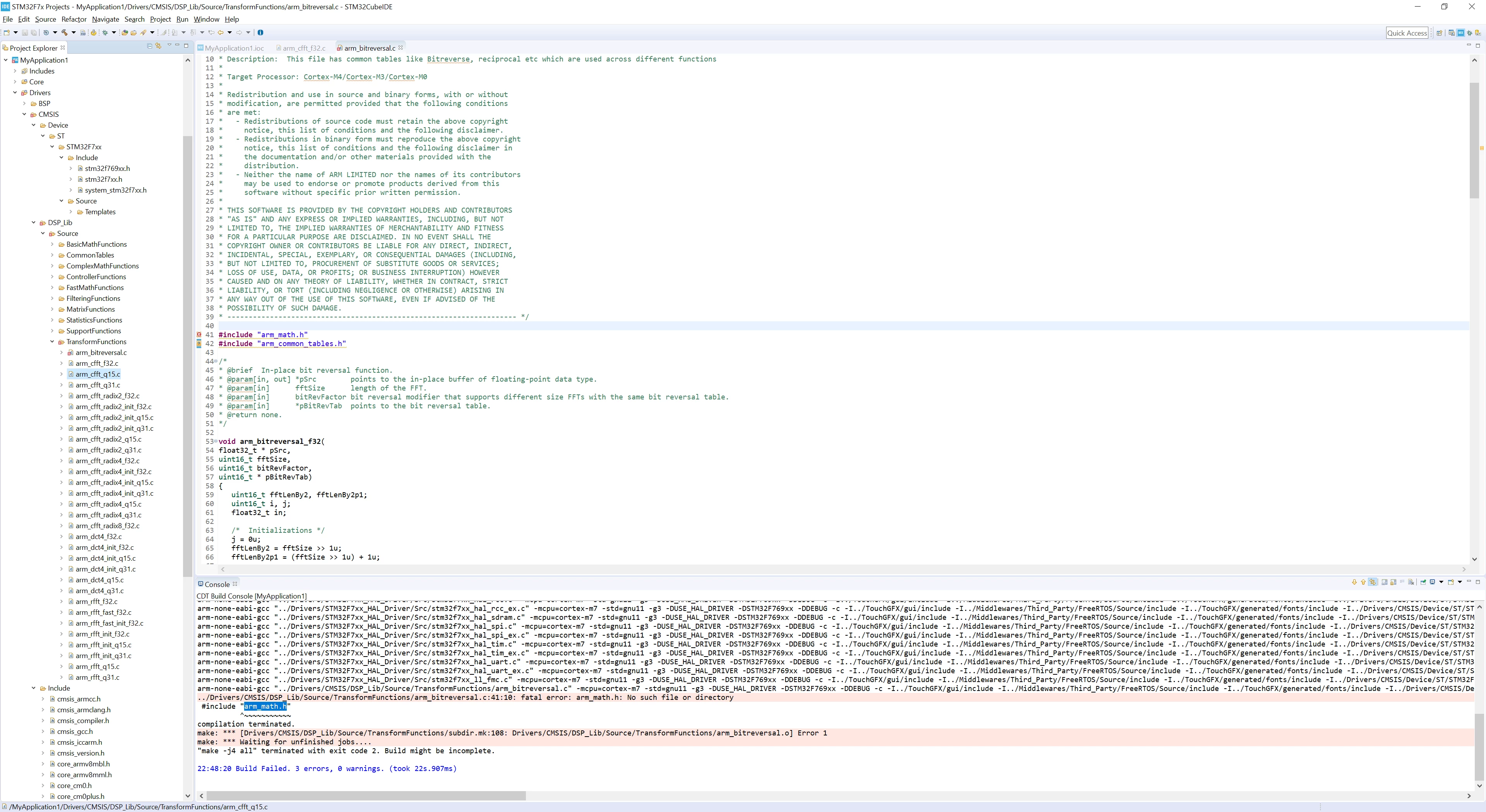

STM32F769i-DISCO board project does not compile
Hi, I have generated a plain project code with one button for STM32F769i-DISCO board.
It does not compile due to missing arm_math.h and arm_common_tables.h files.
I would appreciate any pointers. Screenshot attached. TouchGFX Designer version 1.10

Set the Include Paths properly so they include the CMSIS directories holding the files in question.
CMSIS\DSP\Include\arm_math.h
CMSIS\DSP\Include\arm_common_tables.h

Thanks. The mentioned files are not found anywhere. This may be a bug.
