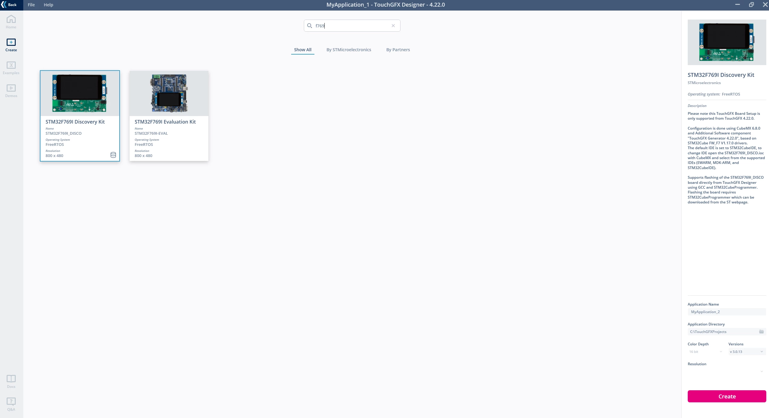

The easy way to start is to open TouchGFX Designer and select the appropriate TouchGFX Board Setup.
In your case it is the STM32F769I Discovery Kit :
Then, you can either start a blank application by click on the "Create" button, or navigate to the Examples/Demo tab to start your application with a example project.
After creating the project, it should already contain the basic software and hardware configuration required to make your project run on the board.

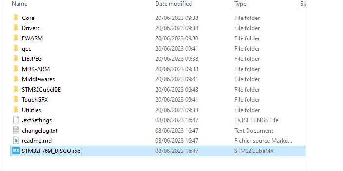

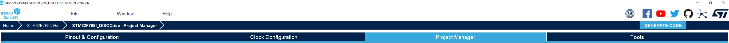

If you want to change something in your hardware/software configuration, you have to open the .ioc file of your project in STM32CubeMX. For that, you can simply double-click on this file at the root of your project :
Don't forget to regenerate code with STM32CubeMX after modifying something there.
