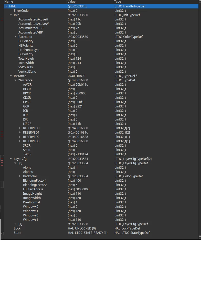

Even SWD re-program has been verified not to reset LTDC. Only POR is confirmed to reset it.
Stepping code while hanged gives no clues as of yet. Registers are exactly the same in hanged/working.
Attached gdb dump of LTDC registers when hanged (same as when working).

This does not help. We have removed the display completely, re-attached it, soft-reset the SOM and still stuck.
Next task is for us to connect a oscilloscope and check all clock and data pins.
We should also check if the LTDC_IRQHandler is still active.

We have found that all signals are OK (clock, DE, pixels) from CPU with oscilloscope, so problem must be with display.
