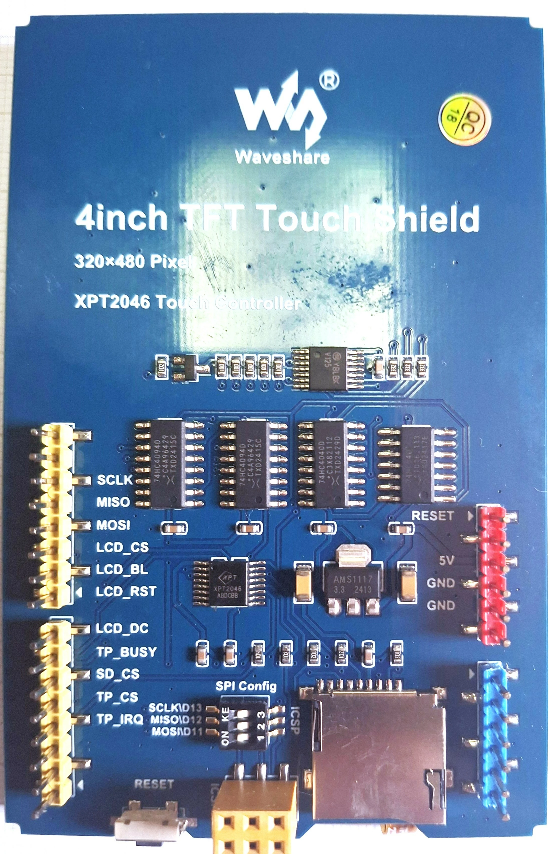

Hello everyone,
I'm trying to interface a Waveshare 4.0" TFT Touch Shield (SKU13587) with an ILI9486 LCD controller using an STM32F767ZI.
The display communicates over SPI, and the SPI bus is shared with the XPT2046 touch controller. At this stage I am testing only the LCD. The touchscreen is completely disabled and is not accessed by the software.
Hardware
  • MCU: STM32F767ZI
  • Display: Waveshare 4.0" TFT Touch Shield (SKU13587)
  • LCD Controller: ILI9486
  • Touch Controller: XPT2046 (not used during testing)
  • Interface: SPI

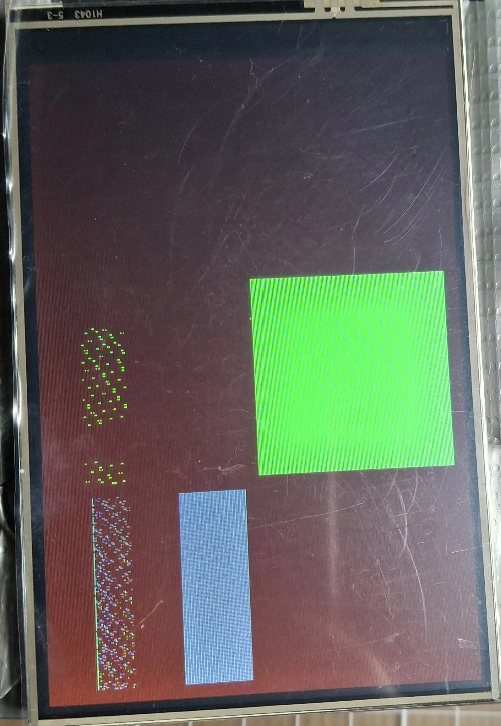

Problem
The problem appears only when I draw a filled rectangle (or any larger filled area).
The rectangle itself is drawn correctly, but additional unwanted pixels appear beside the rectangle.
The artifacts have some interesting characteristics:
  • They always appear at specific X coordinates.
  • Their Y position never exceeds the height of the rectangle being drawn.
  • The larger the filled area, the more visible the artifacts become.
  • Single-pixel drawing never produces these artifacts.
I've attached pictures showing the problem.

Since single-pixel drawing works correctly, I suspect the issue is somewhere in one of these areas:
  • SPI data transmission during continuous pixel streaming
  • Address window programming
  • Loop that sends RGB565 pixel data
  • Number of transmitted bytes
  • Off-by-one error in width/height calculations
  • Incorrect handling of CS during long transfers
  • HAL_SPI_Transmit usage
  • ILI9486 auto-increment behavior
Questions
Has anyone experienced similar behavior with an ILI9486?
Could this be caused by:
  • an incorrect address window,
  • a timing issue,
  • SPI transmit routine,
  • cache/DMA problem,
  • compiler optimization,
  • or a known ILI9486 peculiarity?
I would greatly appreciate any suggestions or ideas.

August 12, 2026
What frequency are you running your SPI at, is it in spec?
To me, it looks like the green block is made of lines, like if every other line is black. The blue image looks somewhat blotchy to me, but it’s hard to tell.
My guess is that the address is incremented too quickly, and that the leftover pixels are drawn outside the window at some point.
Do you have a logic analyzer you could attach to the SPI lines?
AScha.3
August 12, 2026
as your 1 pixel writes going fine, the problem is in the timing , writing pixel in sequence.
So i just cal tell, how i do: (my last TFTs been with ST7789 and ILI9488 )
  • have soma delay after start, until access TFT first time ; (some controllers doing strange things ...)
	HAL_GPIO_WritePin(LCD_RST_GPIO_Port, LCD_RST_Pin, GPIO_PIN_SET);		//  lcd_reset off;
HAL_Delay(150);
lcd_init_command_list(); // lcd init
  • do all write without DMA ; better to find out the timing problem.
  • set SPI clock not too high, try 8 MHz or so; to exclude any “..too fast” problems.
  • check before (!) writing to SPI : Tx free ? ...then write or wait until free.
Should it work now fine, make it fast, step by step, easy to find out, what makes the problem.
