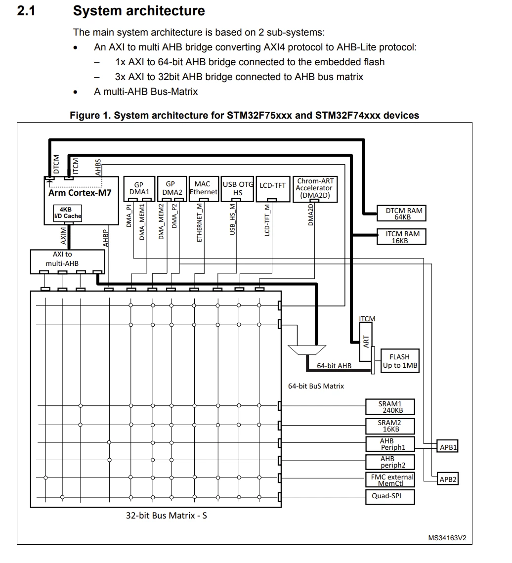

Now, there are two pieces of information in the STM32F756ZG datasheet.
From their circuit diagram:
From Section 2 of their Reference Manual:
If I use the information from the circuit diagram, then it is sufficient. If I use Section 2, then I do not have enough. Because of this, I have two questions:
1) Can I actually use 320 kBytes for the display or 240 kBytes?
2) If 240kBytes, is there a way to reduce the display requirement to get it from 261kBytes to 240 kBytes?
Thank you in advance.

So does that mean I'd have access to 320 KB in contiguous memory?
Tesla DeLorean
Guru
Mar 23, 2023 6:20 PM UTC
SRAM1 240KB is the only one I think you have clean bus/DMA access too
