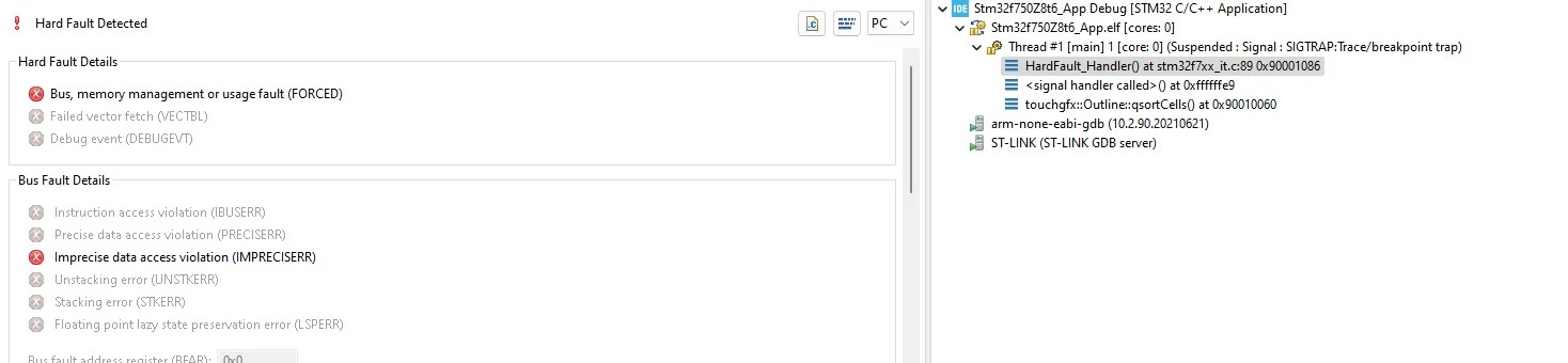

STM32F750Z8T6, SDRAM and QSPI and TouchGFX : hardfault occurs randomly
Hi everyone,
I'm trying to make a simple project consisting of STM32F750Z8T6 (taking instructions from QSPI), a 480x272 display (using LTDC), and a W9812G6KH-6I SDRAM (using FMC).
The project consists of a single screen representing an analog and a digital clock.
The project seems to work but suddenly a random hardfault occurs and I don't understand why.
Can anyone help me figure out what is the cause of the error?
Which settings did I set incorrectly
I share the project (Application + Booloader)

Tesla DeLorean
Guru
Mar 13, 2023 9:46 PM UTC
Have a Hard Fault Handler that outputs actionable information and try and root-cause that, at least narrow the "random" failure to something a tad more specific.
Like exiting interrupt handlers, corrupt stacks, invalid pointers.

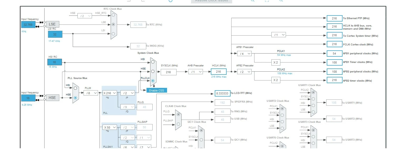

So I tried to enable one piece at time starting from a basic configuration: microcontroller and LCD.
I enable internal RAM for LCD buffer, QSPI for fetch instruction and I disabled Art accelerator, DMA2D, FMC, (FREERTOS is not enabled).. I loaded also an GUI example.
I think , clock is setted correctly:

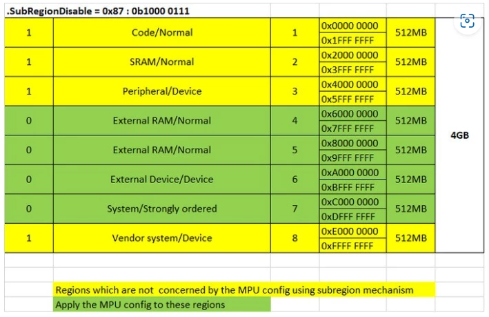

N. SANTINI
Apr 21, 2023 6:49 AM UTC
Your MPU configuration misses the most important region, the one that disables all accesses to external memories :
 MPU_InitStruct.Enable = MPU_REGION_ENABLE;
 MPU_InitStruct.BaseAddress = 0x00;
 MPU_InitStruct.Size = MPU_REGION_SIZE_4GB;
 MPU_InitStruct.AccessPermission = MPU_REGION_NO_ACCESS;
 MPU_InitStruct.IsBufferable = MPU_ACCESS_NOT_BUFFERABLE;
 MPU_InitStruct.IsCacheable = MPU_ACCESS_NOT_CACHEABLE;
 MPU_InitStruct.IsShareable = MPU_ACCESS_SHAREABLE;
 MPU_InitStruct.Number = MPU_REGION_NUMBER0;
 MPU_InitStruct.TypeExtField = MPU_TEX_LEVEL0;
 MPU_InitStruct.SubRegionDisable = 0x87;
 MPU_InitStruct.DisableExec = MPU_INSTRUCTION_ACCESS_DISABLE;
The External RAM memory region is critical, since it is by default Normal memory type and executable and Cortex®-M7 may perform speculative reads to this area, even when there is no memory connected.
The recommendation is to create a safe background region, where the default attributes of the External RAM memory region will be changed (no speculative access allowed).
So, this MPU config makes 4GB not accessible except subregions set to 1 in MPU_InitStruct.SubRegionDisable structure member.
_legacyfs_online_stmicro_images_0693W00000biYpiQAE.png.SubRegionDisable means disable current MPU config for subregions set to 1.
In a given MPU region, there are 8 subregions. So if you divide 4GB (in this case) by 8 you will find 512MB. If you look at memory mapping of default MPU of ARM (4G), you can notice, there are 8 address ranges of 512MB.
There are 4 subregions (of 512M) targeted by this default MPU config in the range: 0x6000 0000 to 0xDFFF FFFF which corresponds to external memories range (FMC, QSPI, OSPI etc ..).
In the above MPU config, each subregion has a size of 512M. MPU_InitStruct.SubRegionDisable = 0x87, will prevent regions in yellow to being set by this config. These regions still in their default MPU config.
SubRegionDisable = 0x87 : 0b1000 0111 --> each bit set to 1 means: don't apply the current MPU config to that subregion.
Please try again with this region defined as MPU_REGION_NUMBER0 then change the region number of the other regions you defined for QSPI and QSPI control registers.
Best regards,
Nicolas

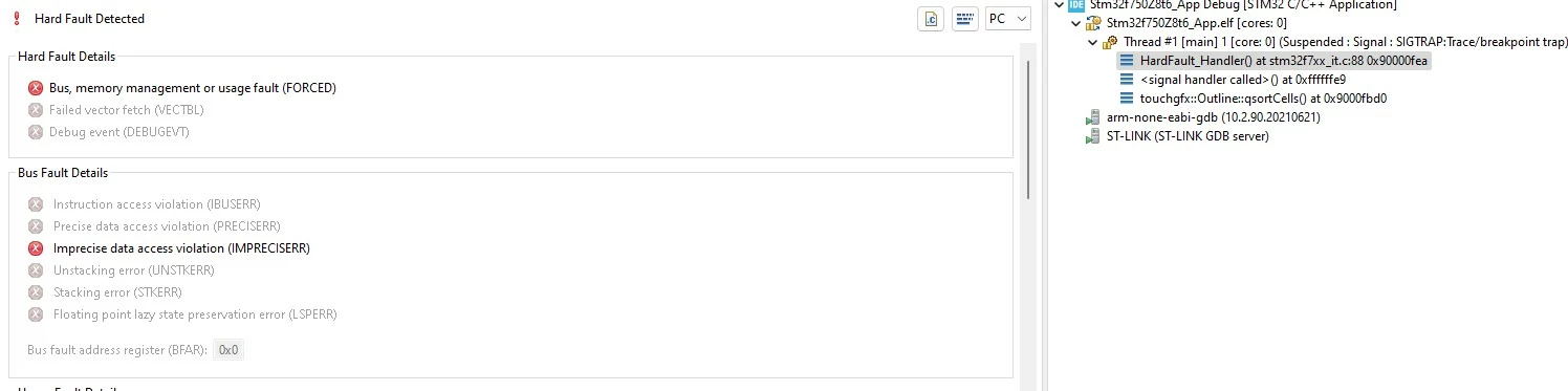

MPast.1
MPast.1Author
Senior
Apr 21, 2023 8:07 PM UTC
I tried to follow your hints, but without success.
Using the following settings, is still not working. it crash!

Is there the possibility that Bootloader has some problem about MPU?
Must I copy the same settigns on it? I think no, because the App should reset all the necessary new settings.

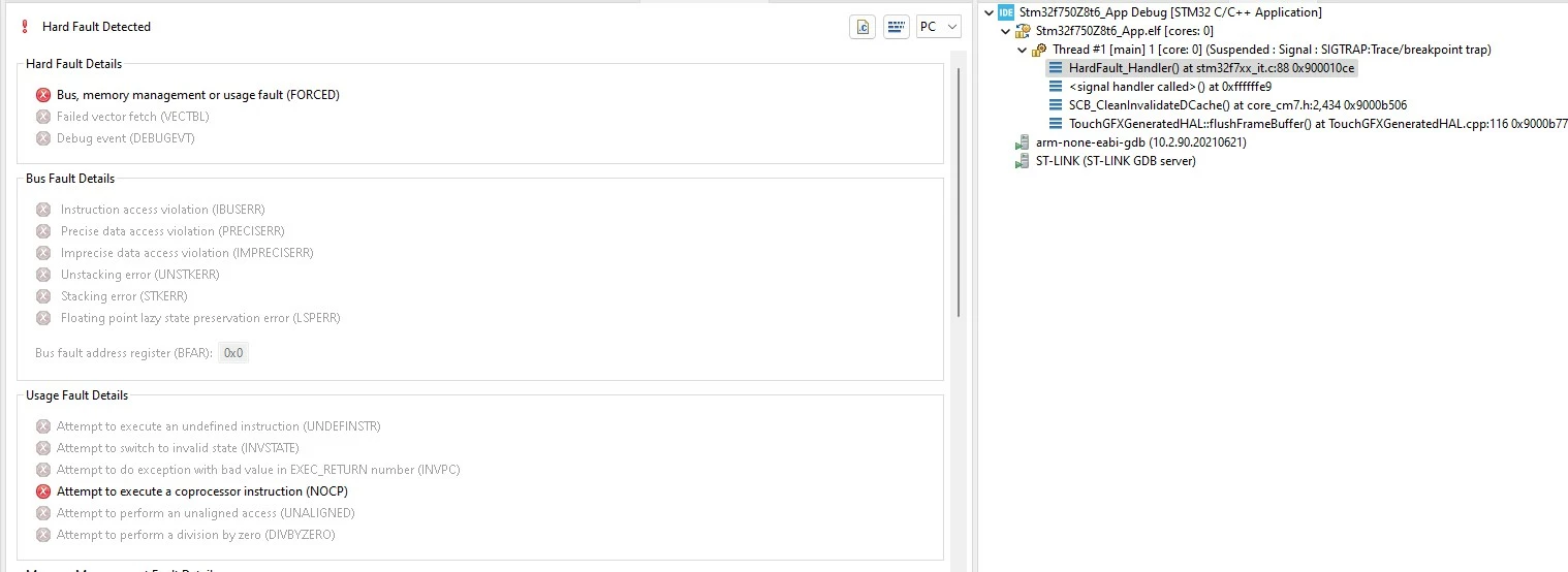

MPast.1
MPast.1Author
Senior
Apr 24, 2023 10:19 AM UTC
Hi All,
I have an update using these settings both for App both for Boot I got an performance improvement:

Respect the previous settings, the actual code block itselft after some minutes than some seconds of prevoius code.
I tried to enabled DMA2D accelerator on touchgfx settings and on CortexM7, changing tye of Flash interface to TCM and enbleing ART Accelerator.
But these changes doesn't solve.
(I remember you that I have only LTCD, QSPI , internal RAM and the project use External BOOT + APP. I'm using ST "gauge example" for my User interface).
What others settings are missing or can be wrong?
Thanks in advance.

 MPU_InitStruct.Size = MPU_REGION_SIZE_16MB;
 MPU_InitStruct.SubRegionDisable = 0x0;
 MPU_InitStruct.AccessPermission = MPU_REGION_FULL_ACCESS;
It defines the region as "strongly ordered" which is preferable in your case since 2 masters are potentially concurrently accessing it (Cortex and DMA2D).

From what I see it seems that frame buffer gets corrupted or at least the reading of the frame buffer content is incorrect.
This may be linked to a clocking issue, what is the FMC clock in your project?
According to datasheet (DS12535_DS10915_DS10916_Book.book (st.com)) Rev 1 page 175 the maximum FMC_SDCLK is 100Mhz, maybe you are above this value? In this case the behavior is not guaranteed.
