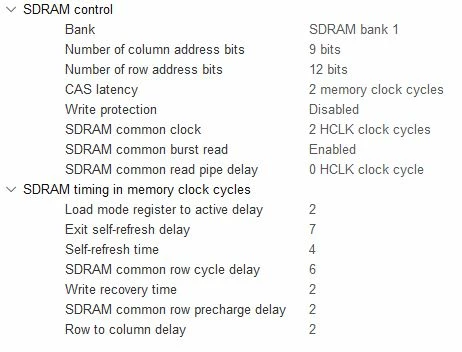

I am working on my custom board and build a project with CubeMX.
In my project, i used STM32F750N8, W25Q128 in memory mapped mode, 24 TFT LCD, TouchGFX.
When i build and load the project, pictures dont loading correct way. In the video you can see what i am talking about.
Why is this happining? Is this about sdram timing issue, or ltdc clock config?

Hi, looks like it could be SDRAM configuration. Could you double check settings?

Hello @Martin KJELDSEN​
Sorry for my late response. I was working with new STM32CubeMX (5.4). It was hard to implement my old (5.3) project to the new one. 5.4 giving me vierd errors.
Anyway, when i write 0x00 or 0xFF (did not try any different value);
for(uint32_t *i = (uint32_t *)SDRAM_DEVICE_ADDR; i < (uint32_t *)(SDRAM_DEVICE_ADDR + SDRAM_DEVICE_SIZE); i++)
		*i = 0xFFFFFFFF;
		*i = 0x00000000;
there is no problem. But if i dont write any thing to the SDRAM, problem occurs.
I am using MT48LCM16A2TG SDRAM. Here is CubeMX timing values;
I checked values from datasheet. But i dont know why did happing.
So, if it is about sdram configuration, Why no problem occurs when i clear sdram?

Did you use MPU for ltdc buffer?
I've flickering issue when using ltdc, and it solve after i using MPU for ltdc buffer.
Or have you check the contact of lcd connection?
