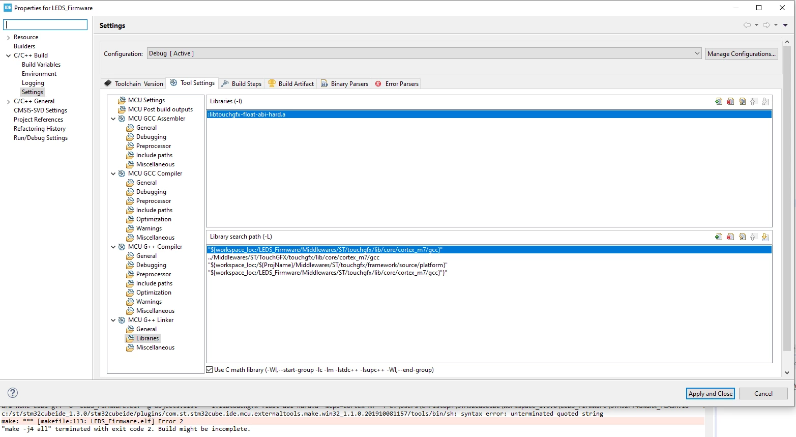

May 15, 2020
Hei Martin,
I've got the same problem and I think I've identified the cause:
When I click "create code" in the Designer it adds a corrupted line to the linker library search paths in the project file (see also attached screenshot).
<option IS_BUILTIN_EMPTY="false" IS_VALUE_EMPTY="false" id="com.st.stm32cube.ide.mcu.gnu.managedbuild.tool.cpp.linker.option.directories.1276840366" name="Library search path (-L)" superClass="com.st.stm32cube.ide.mcu.gnu.managedbuild.tool.cpp.linker.option.directories" useByScannerDiscovery="false" valueType="libPaths">
 <listOptionValue builtIn="false" value="&quot;${workspace_loc:/LEDS_Firmware/Middlewares/ST/touchgfx/lib/core/cortex_m7/gcc}&quot;"/>
 <listOptionValue builtIn="false" value="../Middlewares/ST/TouchGFX/touchgfx/lib/core/cortex_m7/gcc"/>
 <listOptionValue builtIn="false" value="&quot;${workspace_loc:/${ProjName}/Middlewares/ST/touchgfx/framework/source/platform}&quot;"/>
 <listOptionValue builtIn="false" value="&quot;${workspace_loc:/LEDS_Firmware/Middlewares/ST/touchgfx/lib/core/cortex_m7/gcc}&quot;}&quot;"/> <---this is the problematic line
 </option>
Sadly, I don't have a solution :grinning_face_with_sweat: For now I have to erase the entry manually every time I made a change in the Designer.
