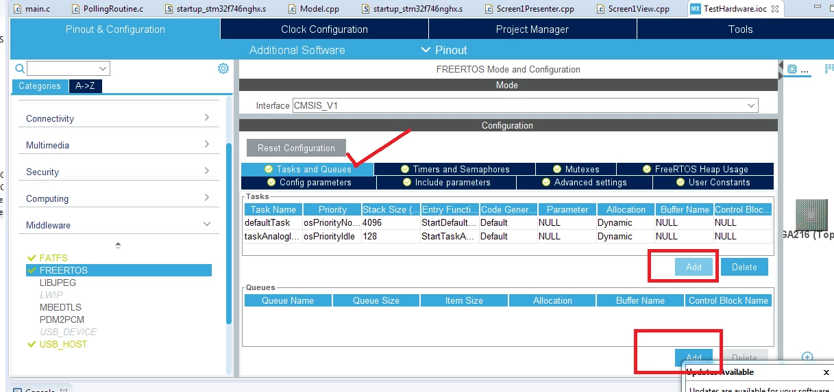

Hi!
How to set FreeRTOS for 2 tasks and queue 2?
How to add support in main.c and Model.cpp?

Karan 123
Senior
April 24, 2020
Please Check Below Image . Hope this helps..

Hi! I set. I generated the code. But what's next? Andrzej pt., 24 kwi 2020 o 19:41 ST Community napisał(a):
chaaalyy
Senior II
April 24, 2020
After creation with cubeMX, you´ll find the new "task function" in main.c (scroll far down to find it...). In model.cpp, you can declare the generated queues and semaphores external (as they are already prepared in main.c) and use them, as usual. If you need an example, how to work with freeRtos together with TouchGFX, maybe this could help you:
https://www.youtube.com/watch?v=EbWOv_0Lp-U&t=1855s
Maybe the context (ADC via DMA...) isn´t interesting, but it shows very well the basic principles :)
