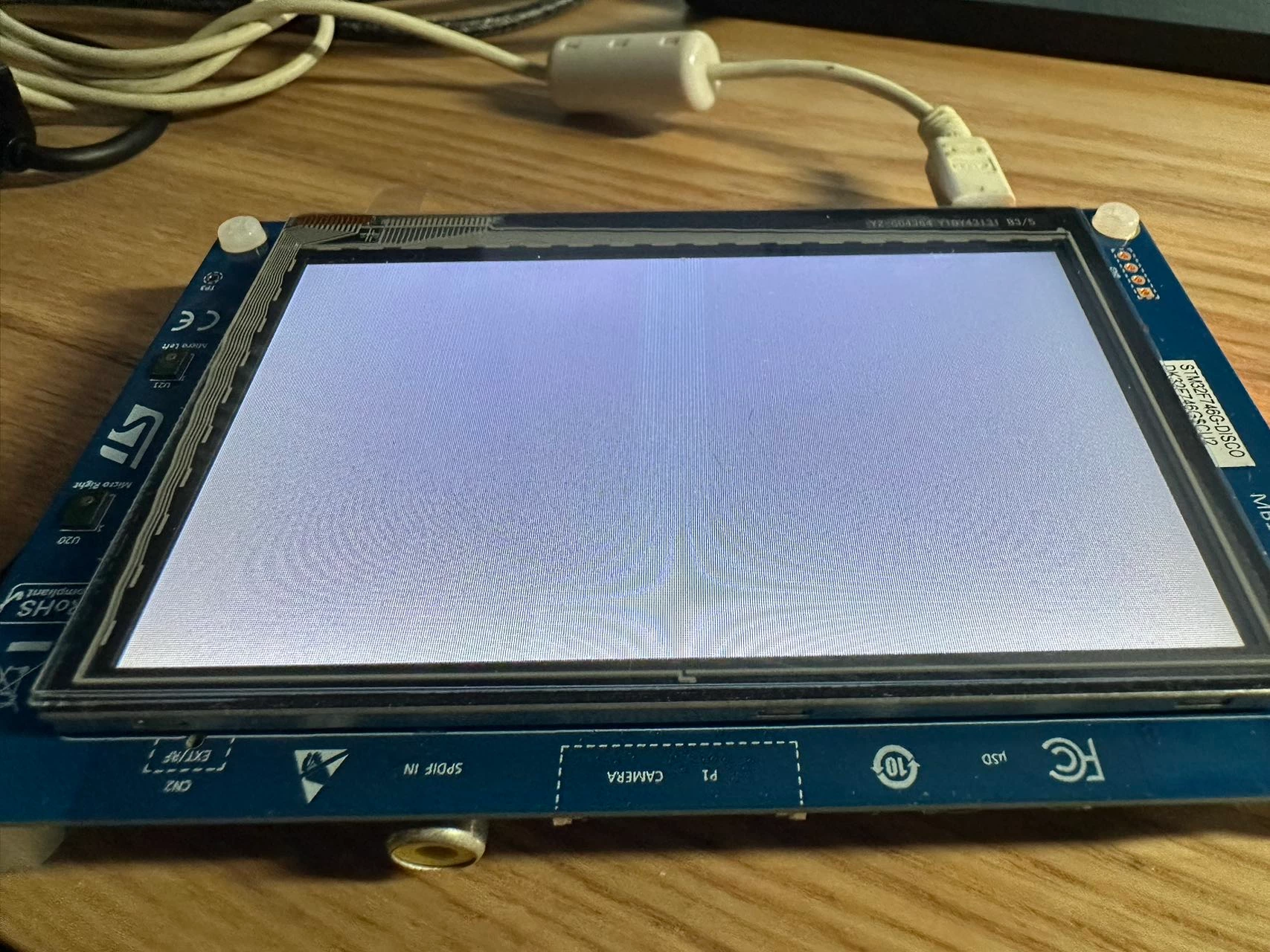

The interesting is there are some lines which can be seen after programming the project, while it is pure clean if I erase the full flash chip. Please check the attached photo.

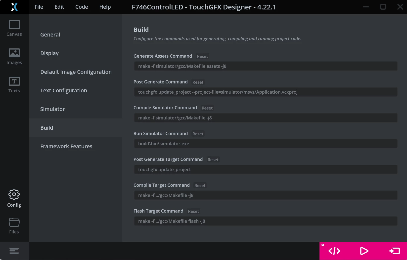

Hello @Tesla DeLorean ,
May I have more information about the build options? The following is the screenshot of the build options in my TouchGfx.
